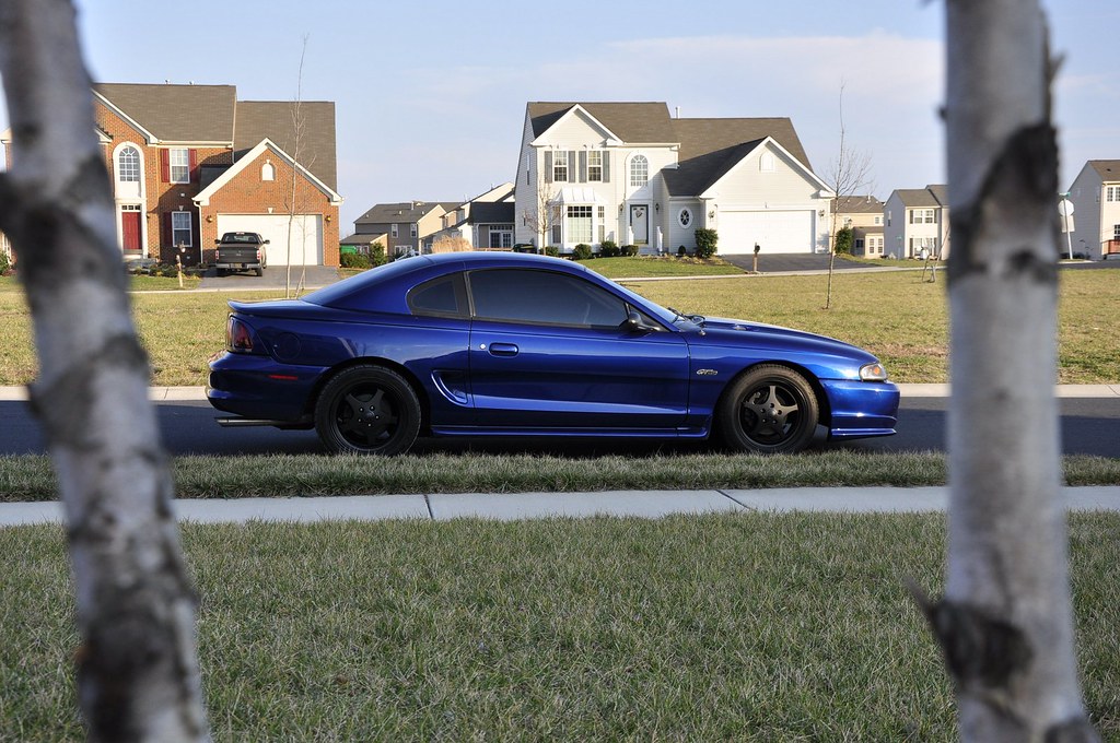

you dont have sportlines....
I have sportlines with no isos and can barely fit 2 fingers in my fender gap up front
X2 ball joints without the spring spacer will lower the car as will removing the isos. Figure out what springs you have first to see if its even sitting right, then go from there.
