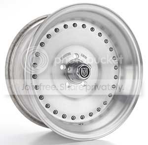

Lastly, has anyone seen or have pics of a New Edge with Centerline Auto Drag 05’s:

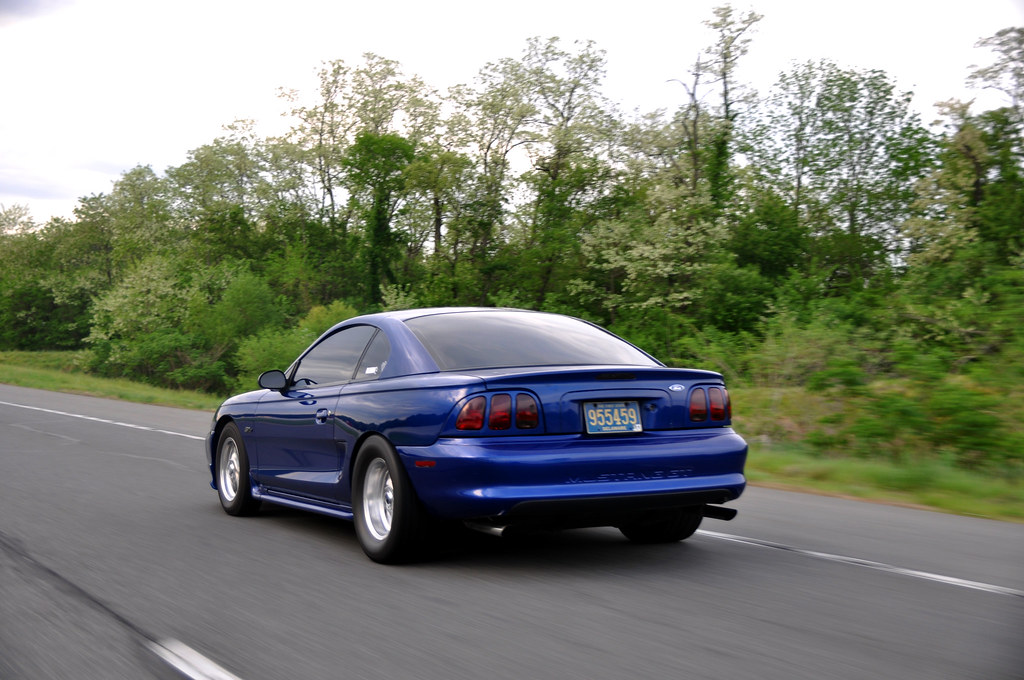

heres my billet specialties...I might throw them back on after the winter lol...love them

rolling shot is 15x8 4.5 bs with 295 street tires

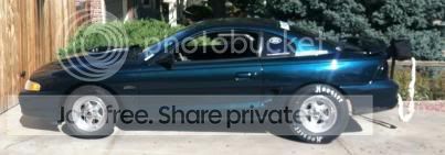

still shot is 15x8 5.5 bs with 275 drag radial fyi

Justin, that picture of your car rolling is exactly the kind of look I'd like.
How far is she lowered and did you need to use caster/camber plates?

Yes on the CC plats and I was on eibach sportlines, no isolators.
I think its like a 2 inch drop or so
