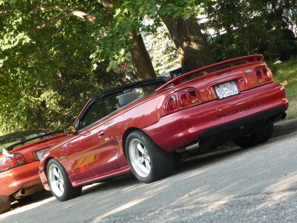

Thank you, and here is a pic of my car from last weekend.
