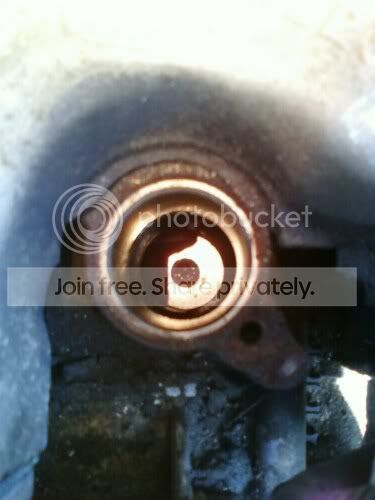

So while I was working on replacing the dizzy, I pulled the old one out. When I did that, I looked into hole the dizzy goes into, and I saw this. Next to the gear that meshes with the dizzy gear, there is a piece of metal in which the dizzy shaft slides into. Is it supposed to be shaped like that and not a full circle? Or is something fubared? Trying to figure that out before putting new dizzy in...
Thanks dudes!

FYI: Followup in case anyone else comes across this, I ended up replacing ignition coil, TFI module, and Distributor. If I remember correctly,in the end, it was the halls effect sensor in the distributor not working properly, which wouldnt tell the fuel pump to run. Pulled old dizzy, plugged it in, rotated by hand, but didnt hear fuel pump. put in new dizzy, rotated it and fuel pump came on.
CC'S95GT
Apr 19, 2008
10,715
178
Hampton ,Ga.
That is correct.
The rotation of the dizzy is what keep the F/P running, once the initial start circuit as timed out.
78,555
