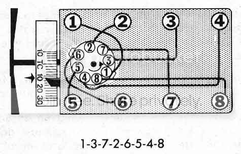

Did you accidentally use the non HO firing order on the plug wires? That will get you to almost start but not quite. Just a thought. Here is a 5.0HO and 351 diagram
