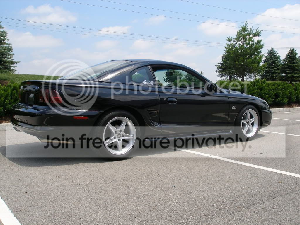

Here is a picture of how my car sits right now. I just want it .25'' lower in the front and .5'' out back. The problem now is when I hit a dip the top of the spring loses contact with the top spring perch and makes a loud noise which cant be good. So do you think the ride will be ok with 200lb springs and that low? The ride is good right now with the 175lbs springs they are just too long.

Holy smokes you're almost as low as me up front. 12" is fine if you're drag racing, otherwise I'd be running a 10" and a stiffer spring rate for the street. I cannot say how the car will feel on the street if you go lower, but, I can only think that you'll be bottoming out on a soft rate spring and having that low of a ride height.
