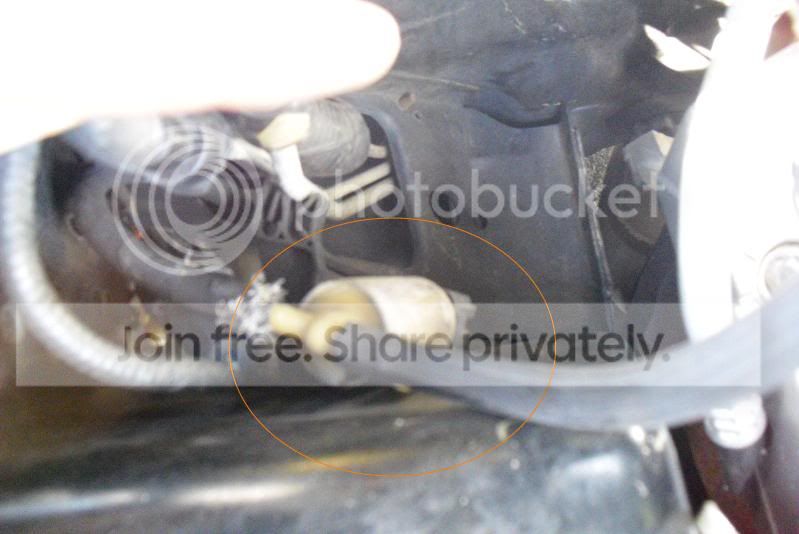

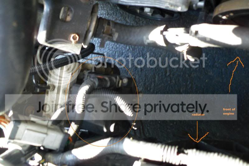

kind of off topic, but its my own thread so who cares lol. i have a quick question reffering to something else in the bay, that im not sure what it is.
not that i want to remove it i just would like to know what it is.
also, whats this for? located in the pass side against the firewall.
again doesnt really matter what they do im just curious to know for my own knowledge.

Re: 98 cobra engine, COP conversion.
i ****beleive**** the second thing (looks like a roll of quarters with two hoses in the top) is your fuel vapor valve. When your car heats up to normal temperatures the carbon canister in you passenger side fender opens up using that valve. When it opens, excess fuel vapors from your gas tank flow into your intake, thus getting burned off.
the top box is clearly a flux compastitor.
