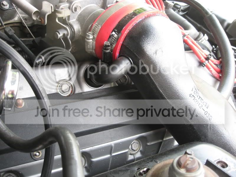

thanks guys ok i have another one for yous.
what is the long tube that goes from the right side of the intake manifold to the intake tube? and whats the purpose of that little box thing attatched to it. i think it looks hideous. i couldnt find anything about it in the haynes manuel but not sure what its called

Thats the IAC tube.
You need that also otherwise your car wont idle. I'm sure you can reroute it to look much cleaner though.
Also(just an observation) you could probably clean up the ignition wires some as well.

ok i figured it had something to do with that, since i forgot to put it back on once and the car wouldnt stay running.
does that little box have a function, or even something inside of it? doesnt seem to open. but yes i thought about maybe re routing it with a whole nother hose, without the ugly box thing. i will experiment with it.
what do you mean clean up the ignition wires? as in straighten them out/lengthen them? not to worried at this point since they will soon be removed lol

i might cut my 2v's box open tonight. ive wondered that for years... lol.
as for needing the tube scoobie is 100% correct. your only option is to re-route it, which is no big deal. a few hose clamps and some hose from autozone. $5.00 modification ;-)

i just went outside to experiment, i used about 4 ft of heater hose and connected it, so i guess it doesnt really matter how long the tube or if the box is there or not, bc it ran fine and idled normal.
i think the box seems hollow. but im sure ive saw a couple people without that box on their tubes, so i guess it doesnt matter much. im sure there a reason for it being there but it beats me.
now i just have to think of how i want to route it, and if i do ill have to plug the hole in the front of the intake tube and make a new one somewhere.

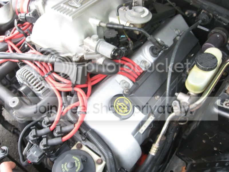

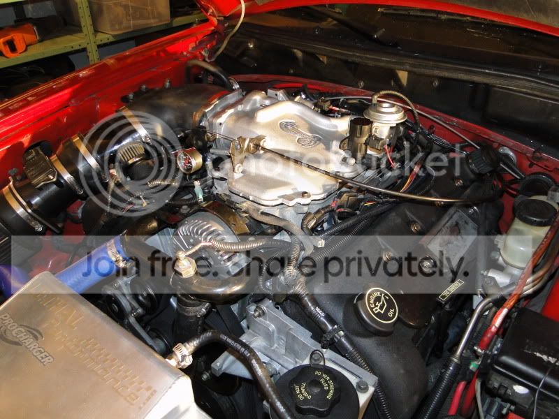

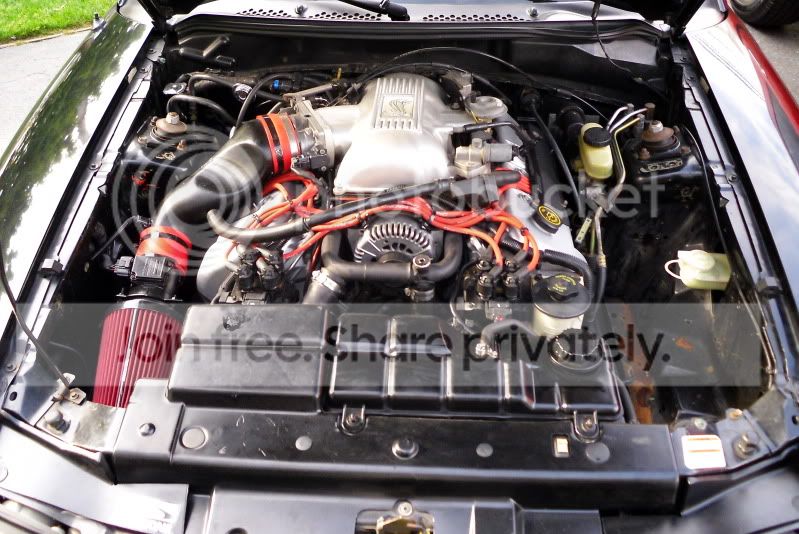

alright heres another question regarding the 03/04 headcovers.
i was wondering if i would be able to put breathers in the holes for the pcv. as shown below, (third pic)
here are how mine are
this is what i want to do when i do the swap( breathers)
the holes on BOTH sides suck lots of oil. :confused1: im going to make a seperator, or if i could just use a breather instead of the pcv valve then thats what ill do.
also on the plus side, if i could use breathers, i wont have to get new hose for the pcv valve, or another hose to put on the *passangerside head to the intake tube.

i suggest a lightning force PCV filter. Its high quality and much cheeper/more durable than steeda's. plus this way you dont have to work woth steeda's tech support. loL!!!!
i suggest keeping your PCV system in tact. once you hit higher horsepower, it wont matter as much, but at this point it does.
The PCV system is the ventalation system to remove old, stagnant air from your crank case. It is open on two ends. One end allows air in, one allows air out. All the air used is *METERED* and *MEASURED* in a closed system. (jsut like your coolant, for example.)
adding a breather cap (used to reduce crankcase pressure on boosted engines) will allow un-metered and un-measured air into the system, thus making it an "open" stystem, instead of a closed one.
for the most part you can re-route the PCV in massive amounts of tubing, if you want to hide it in the fenders, for example. It may cause problems once you hit a certain length.
