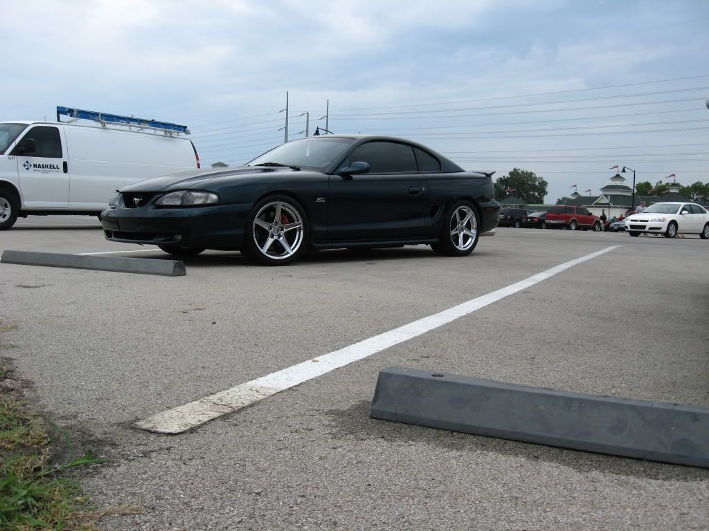

27,321
no insolators, the ride is rough as fuck even with nice struts and shocks.
i think im going back to pro-kit no insolators.

that looks bad ass though im prolly going to have to saw my dumps off and my longtubes will grind all the time oh well lol
