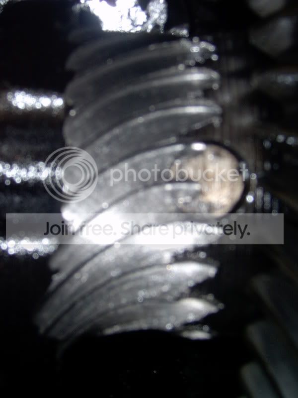

I had a pinion leak a couple seasons ago and ended up with this after a loud banging noise started coming from the rearend on the way to the track.
