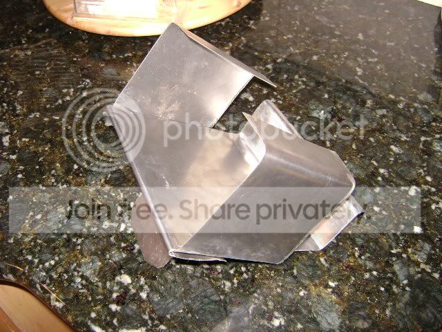

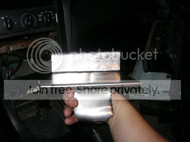

Because I like metal fab and HATE thievin little bastards.....I got creative and bendy............I used the metal cross bar in there for support and place to anchor the chassis........ I also used an anchor on the bottom tab to where the dash is bolted.....
Here's how I cut and bent the chassis..... Has alittle spring in it to keep the skip to a minimum. She's not clean but works like a charm........

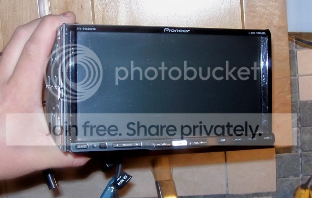

Now for the test fit......
HU-
In the dash-
