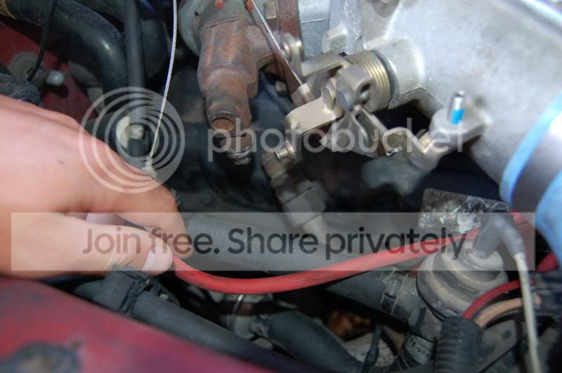

Ive heard from multiple sources that the egr is important with emmisions and it helps with gas milage. I need all the milage help i can get so i would like to hook my egr back up. heres what i have in front of me.
The short piece of tube from the header to the egr is welded on the end. the egr itself has a plug in it.
So if someone could post a picture of their egt hooked up or tell me what connections i need to get to hook it up i would appreciate it.
Thanks
jacob

You will need another tube and another egr if the plug in it can't be removed. Also, make sure there is a tube running to your cats, and another one connecting the heads in the back.

The EGR tube can be purchased new for ~$42 from Ford dealers online. As stated, you'll need to replace your EGR if it's not working or the plug can't be removed.
Simply reinstall the new EGR and tube, and you're golden.

by looking at the picture you can probably see...but i dont get how those two hook up. it looks like there would need to be an elbow or something.
