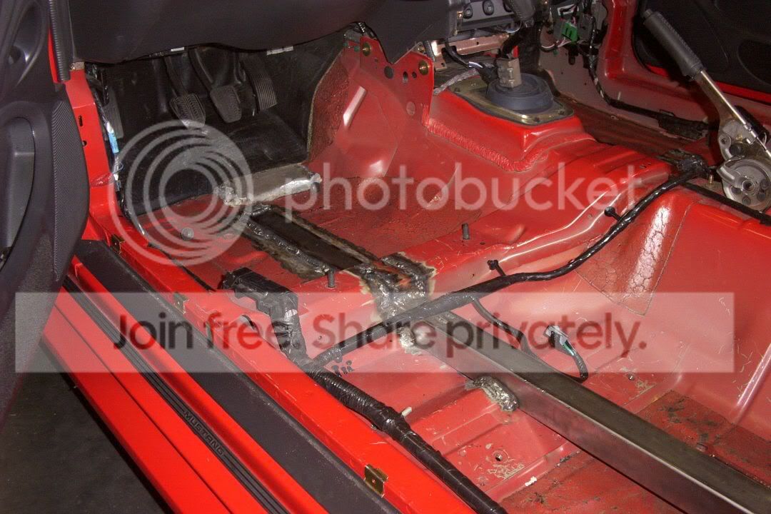

As for the Matrix subframe connectors, that style is a good bracing style, and will give you the best stiffening for the lower subframe. You will still want to do the upper subframe which will end up looking like this. It stiffens more than the lower subframe connectors.

ah, i see what you mean with the uppers. that looks custom but are there any kits out there? floor pan will remain expose so i would like to keep any visible modifications to the pan to be somewhat presentable.
that's interesting about the rigid expanding foam, i may have a go at that
also dumb question but is that all the wiring under the carpet? i am going to try to relocate it so it looks a bare pan with no exposed wiring. tips very welcome

Well nothing bolt-in would add any meaningful rigidity really. I believe that picture is of the Griggs 'kit'. There' a special length and taper on the beam. I've never torn down my interior so I don't know where exactly you would be able to hide the wires. Somebody else will have to comment on that.

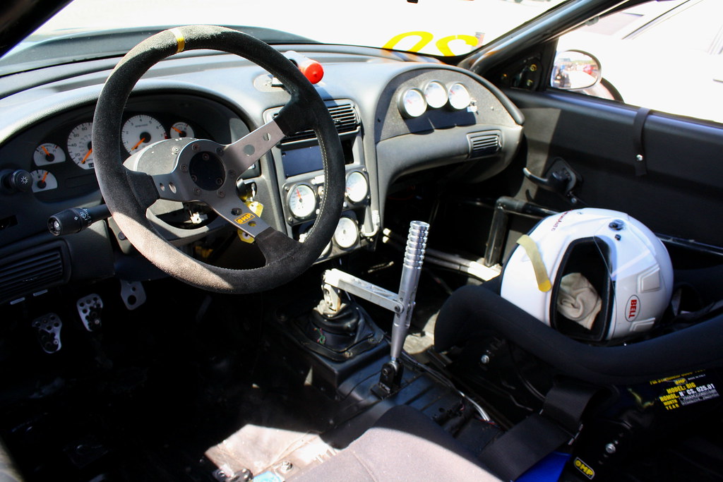

I gutted the interior in my 95 for a few reasons. I was autocrossing it at the time and with the few mods my car had, it was placed in a really high level class and I had no other use for the car so bye-bye amps and radio and Cobra seats, hello Corbeaus. My door panels were crappy and falling apart, my carpet had seen better days, etc etc so I gutted it. Pulled the center console, rear seat, carpet, door panels, all the seat belts and hardware, trunk lining, and all of the trim from doors back. Accidentally busted out one of the rear windows after locking my keys in it and replaced both back glasses with Agent 47 NACA ducts. Do they look racecar, yes. Are they meant for a racecar, yes. Are they good for daily driving, noooopppeee. But they're an option if you want to ditch the rear glass, they're functional obviously is you run some lines but otherwise, you'll have to find a way to cap them off.
I did daily this car for a few months and honestly, I didn't mind it at all. Getting used to harnesses in a street car is weird and really limits being able to look around you. When I get around to getting the car running again, I'm planning on stripping the sound deadening off the floor, installing through-the-floor subframes, and bedlining the interior to keep it relatively "clean" for a gutted car. Also going to install one of those lame super JDM blink mirrors to help see behind me. I loved it but then again, I retained A/C, power windows, power locks, etc. Getting rid of the glass is incredibly overkill and not worth the trouble. Your car will def get toasty in the summer with no real insulation between you and the heat of your exhaust besides metal.
EDIT: Also the only real wiring you have running in the interior runs under the driver seat to the e-brake I think.

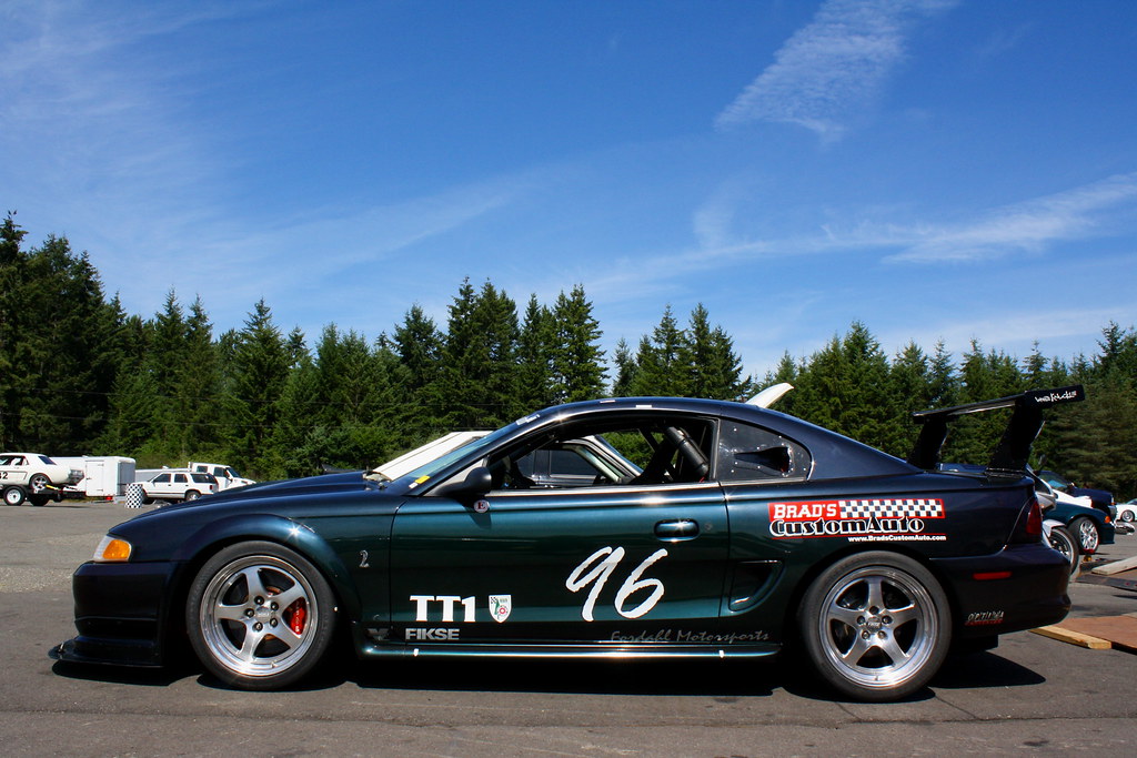

i am going to keep my alpine cd player, road trips will need that although i know it doesn't fit the the theme i am going to replace the speakers with lightweight units and ditch the amps
If you are going to gut the hell out your Cobra, I would worry about a Alpine sound system because you wont be able to hear it through all the road noise!
For some insperation: A gutted a Mystic Cobra done right!

that mystic is tits, anyone know what door panels are in it??
doh, yeah. i forgot about the ebrake stuff, but as long as you have a seat in the car the seat will pretty much cover it.
