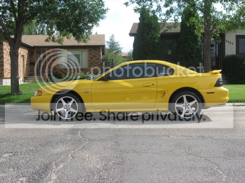

when I was stock suspension I added 03-04 front LCAs when my ball joints went bad. the front became noticeably higher. many other people report this same concern when using these front LCA.
edit: see sig. pic is from that time frame
