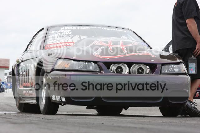

Funny story about dyno's and such since we are on the topic. When we completed our Twin Turbo Outlaw 10.5 car, this one:
We took it to the dyno to tune it. Well we get the base tune in it, getting it idling and starting good, and figure "Hell let's make some power." So we dial it up for 23 lbs. of boost and let it rip, and it made an astonishing 830 rwhp. Out of a twinn 88mm turbo, 440 inch windsor.
Naturally, we were like, what the hell? Everything looked good though, so we let it go and decided it was fine. We took it out testing a couple weeks later and it ran good, so we took it to the Street Car Supernationals in Las Vegas, and it ran A 7.24 @ 3100 lbs...
It was just due to the way that the dyno load operates. Turbo's thrive on load, and if a car is so powerful that it spins the roller quick enough, the load dissapears, and the turbo will stop making power. It'll still be spinning fast, but there just won't be any power there. That's why the turbo cars always feel stronger on the street than their numbers usually reflect.
It's weird stuff sometimes.
