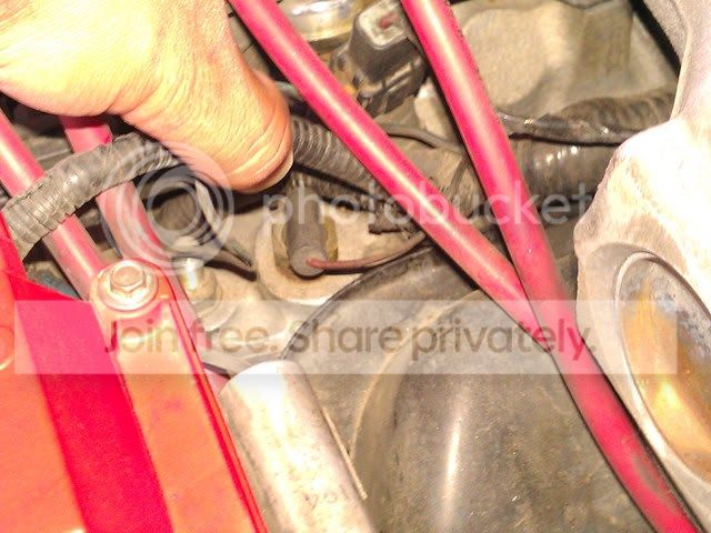

This is the stock water temp sending unit on the drivers side lower manifold and where you are supposed to install the new one:
I need a fitting to do the install, again does anyone now the size of the fitting?

will the stock sensor not reading mess with the computer at all? Thanks for the pic, exactly what I needed.
