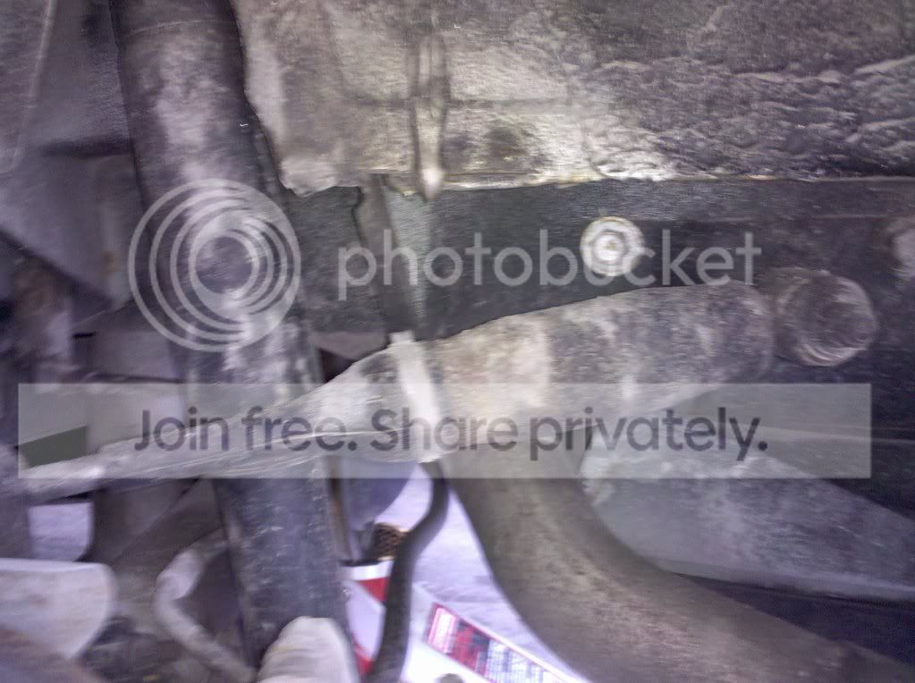

first, take off your wheel.
next, locate your quad shock.
third, notice the 2 bolts right behind your brakes. the one in front is welded to the wheel stub, so you cant remove it. the nut in the back is actually a long bolt, thats the one you'll need to take out. you can see ive loosened it out so you can see it better.
then take out the top bolt.
the shock should just slide off, i didnt take a picture of this step, i think it will be mostly self explanatory how to remove it.
now simply flip it and adjust it as needed.
bolt it back up and re intall your wheel.

distant pictures help. ... a zoom-in of a single bolt will just confuse us, but a distant picture with the bolt in question high-lighted will help. (you can use microsoft paintbrush to draw arrows, add text, and circle things on your pictures)

i bought AC Delcos, which were the EXACT same size (dimensionally) as the FoMoCos that came OEM.
I put them on (flipped,) lowered teh car, and one ended up grinding on the shock and burst open.
It unloaded its juices on my floor. i removed it.

ive driven it several miles and took hard turns and i felt no difference it the performance, i also took off the wheel and saw no rubbing on either shock. i'll be sure to post it if i find something negative.

Very simple procedure that only works on stock factory shocks. No need to sticky.
