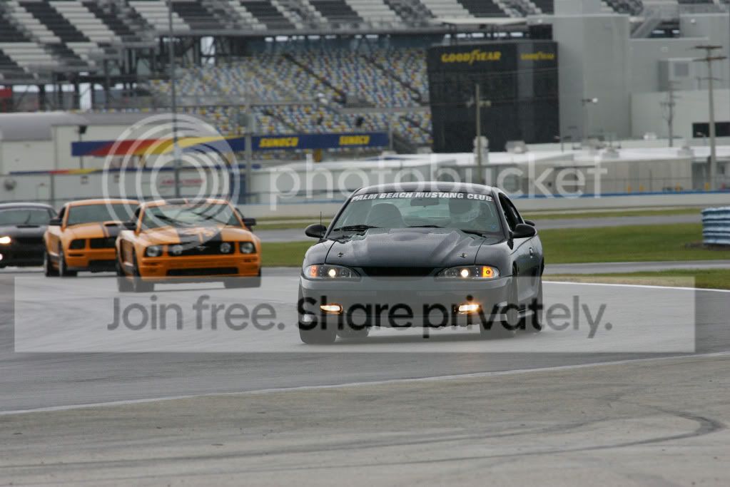

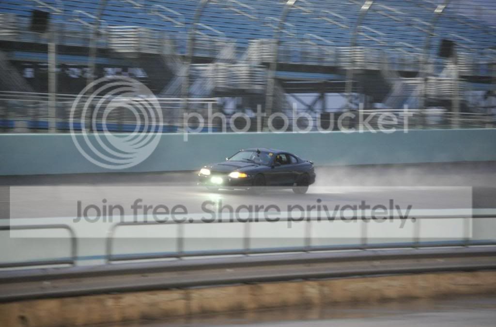

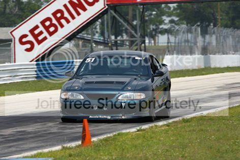

Name............. Victor
Car................ 95 GTS
Drivetrain....... 306 with AFR165's, Holley Systemax Intake, Comp Cams Magnum 281HR, Full Race Exhaust and supporting mods
Suspension..... H&R Super Race Springs, Bilstein HD Shocks and Struts, Steeda 4 bolt Race Caster/Camber Plates, Steeda Front Swaybar, MM RLCA's, MM Panhard Bar, Custom Tower Brace
Brakes........... 13" 2000 Cobra R Front Brakes with custom made air ducts, Cobra rear brakes, Hawk DTC70s in front and 60's in the rear, Motul 600 RBF.
Wheels........... 17X9 Cobra R's on all four corners wrapped in Nitto NT01's in 275-40-17
Tracks run at .. Sebring, Homestead, PBIR=Palm Beach International Raceway, Daytona
Comments..... Bought the car over 12 years ago. Started out as a show and daily driver but soon fell in with the wrong crowd and now it's almost a track only car. Only reason it's not fully gutted is because I still love driving it around and I don't have a truck and trailer to tow it to events, YET........
