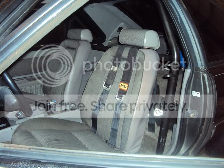

Paul said:
My car will almost exclusively be a street car. (hence the ricer-ism occurring here)
How would I strangle myself with a non-DOT harness? Never heard of that before.
The majority of race harnesses are not DOT approved, but I have no reason to believe they are not much safer than a standard 3 point belt.
Paul.
I phrased that incorrectly I apologize.
Harnesses with just a Harness bar are unsafe. in a severe accident the harness bar can shift rearward or to an angle to wear it could strangle you. That's why I never recommend a harness bar, a bolt-in cage is probably a better idea.
Instead of running a harness bar if you just want harnesses, the Schroth Harnesses are more than enough and they're less of a pain to hook up than a cam lock setup. The schroth Harnesses mount in the stock location but also provide great restraint all while being DOT legal..

Wow.... Holy Shit..... What forum was that pic from? the interior looks like a honda or acura.

Looks bad. Still not sure how that would choke the driver though.
depending on the seat type i've seen it dig into necks, compress the drivers chest so he can't breathe, etc.
We had a driver in NASA HPDE out here a couple years back that mounted his harnesses incorrectly and that's what strangled him (he was using a harness bar). That's what led to the eventual ban of harness bars in NASA.
Considering your reputation, I doubt you'd mount the harnesses incorrectly, but, regardless I still don't recommend a harness bar for the above reasoning.
