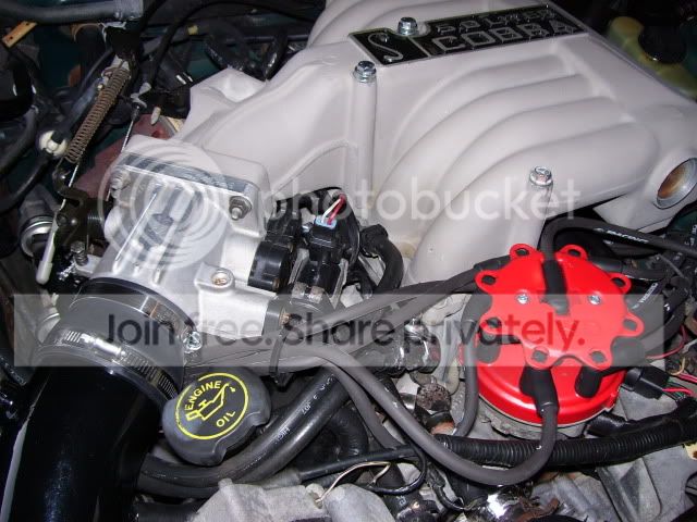

Installed my 94-95 Cobra u/l intake

Did it yesterday, everything went smooth. Car pulls very nice with this addition. Still have a little more underhood detailing to do but here are pics:

looks good. is it a true cobra intake or a chinese one? just curious not pciking at you or anything?

True Cobra upper and lower. Off a 94 or 95 Cobra. Has Ford part #'s on the back of the upper. Yes, i'm planning on grabbing the BBK 2513 Brace. I'm running an old school BBK/Edelbrock 75mm throttle body.

looks great! did you run into any problems with the front or rear lowering intake bolts being rusted? happend to me on saturday broke one of em in the head.
how does it run with that 75mm tb?

LOL Soldier, only if you got some cash for me when I arrive! Thanks everyone. The finish is the factory silver powdercoat. It cleans up very nice. The BBK 75mm TB is not overkill IMHO. The opening on the GT40 intake manifold is 70mm so it's not too far off. Just reset my timing this morning, put it at 14* and yes, the thing pulls nasty. I can't wait to purchase my AFR 165's! sn95gtvert, none of my bolts were rusted, but a few of them did have rust dust forming. I cleaned them up with a wire brush and applied some ARP thread sealer on them and reinstalled.

you are super lucky! its good to hear everything went smooth it looks killer. my swap should be done tomorrow, i went with a 70mm performance products tb and i thought it was gonna be to much.
to bad you live so far away, i'd love to make some pulls against you.

looks great man! i just did installed mine a few weeks ago and love the gains! Sucks i have the stock 16s and crappy tires on for winter bc it just blows the tires off. Cant wait for my 315's back on and go play some! also where did ya get the shock tower black covers? love it man, your car is def one of my favorites
