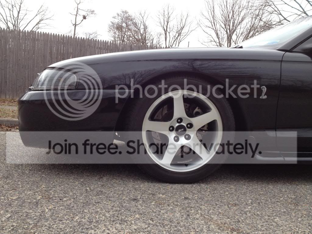

one more question. im pretty sure i have a 12 inch spring, but it doesnt go as low as i want it too. this is what i want it to look like.
but when i do that, this is how the spring sits.
do i need a 14 inch spring? it seems like even that wouldnt be enough. and they are threaded almost all the way down to the bottom of the coilover sleeve.
when i have them adjusted up, so the spring is resting on the adjuster, and touching the upper spring support/ bearing cover, the car is way to high for my liking.
