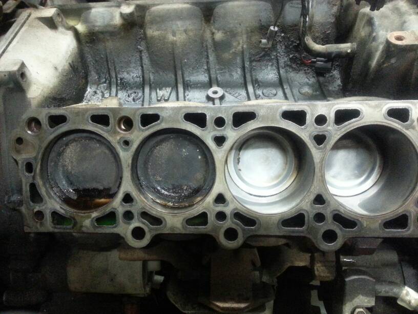

kerosene is basically what sea-foam is...
as [MENTION=16454]slow90coupe[/MENTION] said, hit it with brake cleaner and a tooth brush. Use the old piston rings (cut one of them) to clean out the piston seats. once they are "clean" (you'll never get them like-new. lol) soak them in motor oil for a few hours. let them drip-dry before re-assembly. it will fill the pours of the metal with oil and help with initial start-up, but letting them drip-dry will make it so you can handle them during assembly without dropping them every 5 minutes. lol.

I'll keep that in mind MC but I should have worded it better my bad lol, but the motor is still in the car. So I need to clean them while it's in the car. And I'm finding the tooth brush method is pretty tough on the pistons that are in the bottom of the cycle lol.
But yep! I'm finding I can't get them TOTALLY clean lol its just impossible. But anything is better than what they are now

Thanks guys! Got all 4 cleaned up and a coat of oil on them. All ready to re install the heads and continue on with assembly! I know I know it's taking me forever but I'm only using about an hour or so a day to work on it as I have many other things to work on in the mean time lol. But I'm hoping to utilize my Saturday off (which NEVER happens) and get almost everything done. Heads might go on tomorrow before work, not sure on that yet but definitely will be on Saturday.
Broken dipstick means no matter if I get it completely together or not, I can't run it till I get one in. So that's a bummer :( But we'll see how everything goes!
