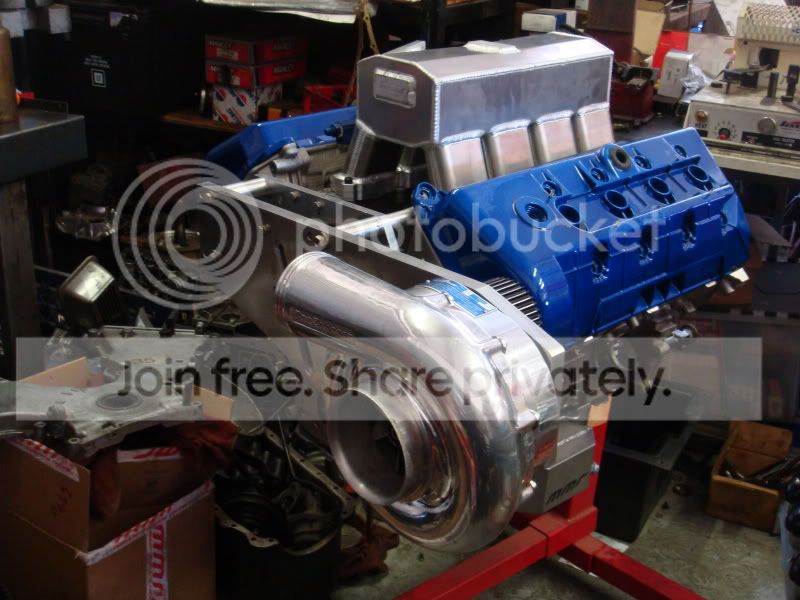

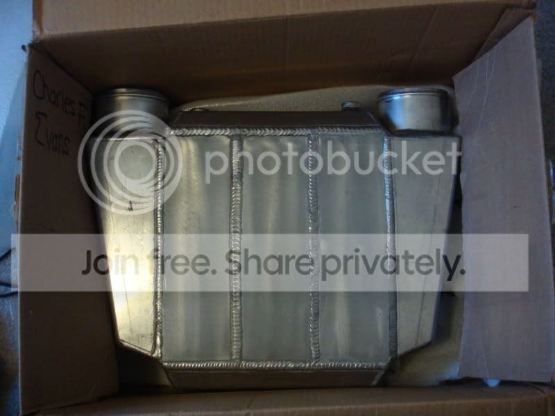

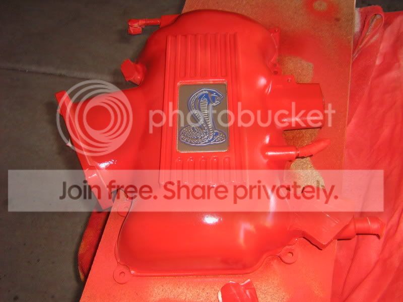

Now the power adder :notworthy:
air to water cooler
:notworthy: :notworthy: :notworthy:
5.0kid
Mar 29, 2008
1,370
Re: Knuckles build thread
lovin the shot of that engine! that intake is sick!

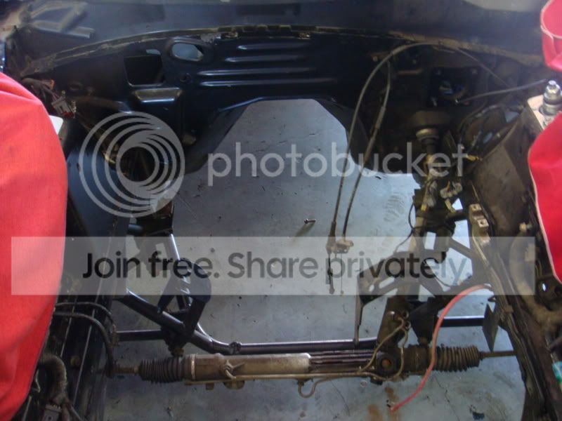

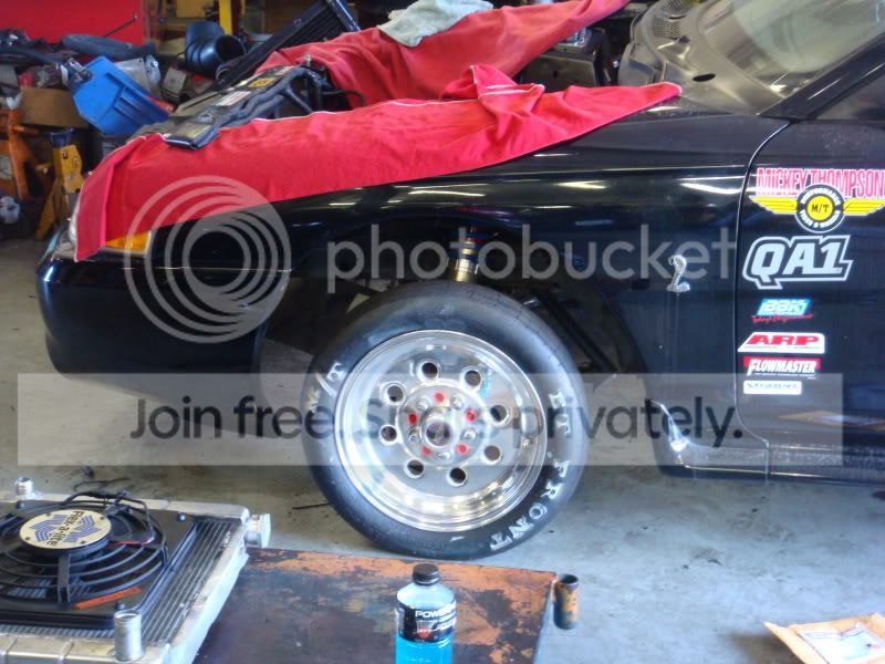

new tiny front runners
looks like a onster truck without the engine. removed the hydroboost and abs stuff, going to be cleaning out the engine bay monday
for right now with no assist unless i can get a good deal on a good manual one, more important stuff to put money into at the moment.

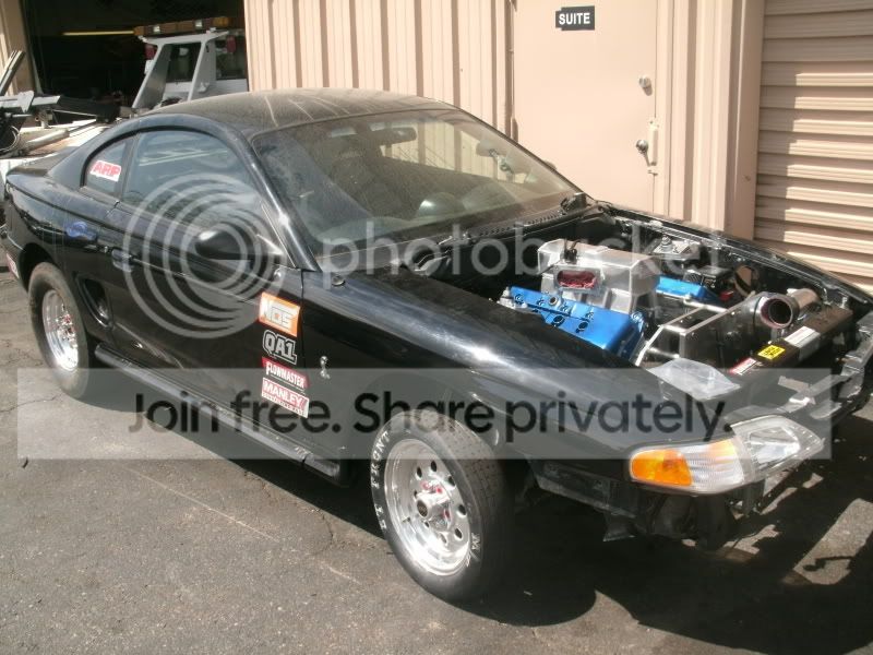

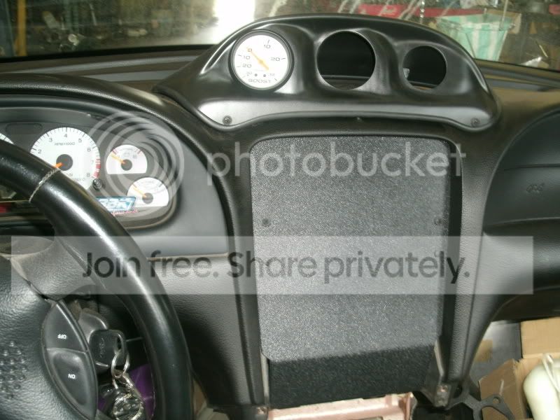

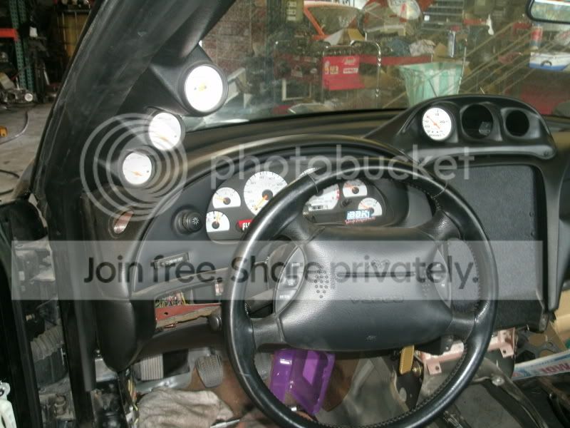

Ok figured time for an update, we got the engine in the car :icon_rr: its been waaaayyy to long since ive seen it in there were it belongs, also got some interior stuff done nothing big just my florida 5.0 stuff put in. Triple gauge pod were the clock goes and a center console delete panel, enjoy.
Knuckles@Empire
Knuckles@Empire
-Never Forget-
Aug 18, 2007
1,099
39
In front of you
thats it for now working on sourcing my tranny at the moment. Also headlights are off getting painted black. Anyways thanks for looking :icon_salut:
Nice progress, that motor looks bad ass sitting in there.
any clearance issues with the hood?
@Dal, no issues as of right now and i dont forsee and in the future i run a cowl hood on it. Right now the hood is getting airbrushed so i should have pics of that next week stoked for that. Big shout out to Twisted airbrushing who decided to throw some sponsorship my way, gonna make my boys proud when track time comes.
@jabird indeed a cage is coming, the car should turn faster than 8.50 so it looks like 12 point here i come. I know a few folks from S and W racecars so i will prolly get a cage from them and weld it in, OR Ryclef can work something out with me and i can bring him my car depending how southern he is in Cali.

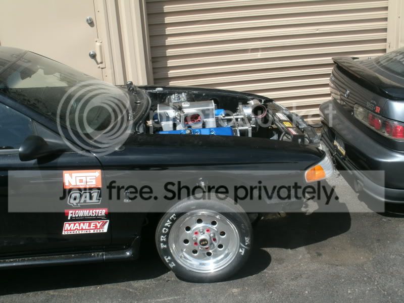

your valve covers are like, 100xs better than mine. lol.
also, it looks like its sniffing that acura like a dog.... ... like its gunna butt-f*** the living daylights out of the thing.... ....
scary build man! cant wait to see it rollin
section 8 powder coating my boy Lou did the valvecovers i had painted them myself with some duplicolor orange shit
not the best looking so he hooked it up, as for that integra while not OMG fast puts down 320ish to the front wheels, that thing on the highway is disgusting. But yeh were making progress shouldnt be WAAAY to much longer before we get her fired up.
