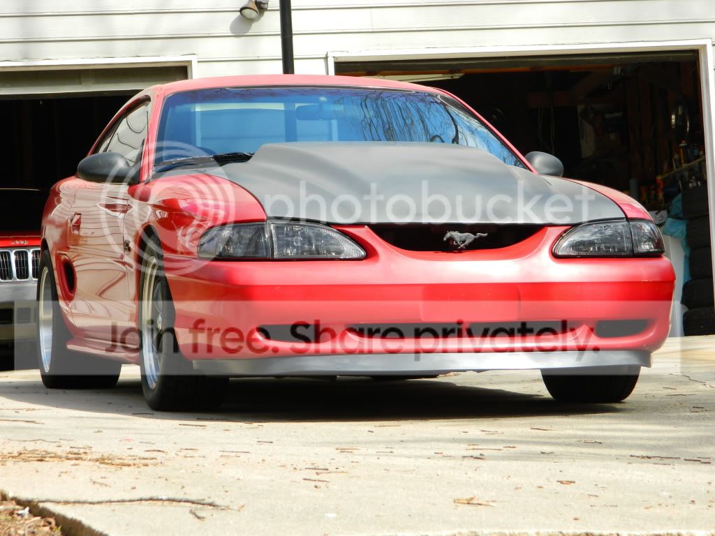

I bought a set of the SVE springs and thought they would be as low as my Sportlines. They are actually a bit taller and when I installed them on the rears & dropped the car back down last weekend, it sat to high for me, granted they may have settled some after a while but I pulled them back out.
I wanted to be a bit lower, not higher, so I ended up pulling all isos from front and back and putting the Sportlines back in. It now is, to me, noticeably lower, netting about another 1/4" - 3/8" drop and am very happy with the results. A short test drive produced no ill effects.
I may sell my SVEs or just keep them to "modify" if I want to go lower in the future.
