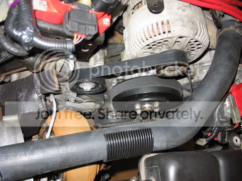

looks pretty sweet.what the hell pulley set up do you have on there,my 96 has a smooth pulley up top,the crank pulley on mines looks bigger and the water pump pulley on mine looks smaller and your belt routing looks diff.please explain?
The crank is a Steeda UD, as well as the water pump pulley. I routed my belt by changing the upper left idler to a smooth and basically deleting the ac without using the ford delete kit. Here is a top view of how I did it and the belt and pulley I used for the delete. It wraps around the smooth pulley, against the tensioner, then around the crank.

nice,ya know when i noticed the belt routing i didnt even think that the a/c was missing but now it makes sense why it looked so diff.good idea tho for deleting a/c and just rerouting the belt like that.
