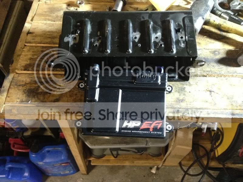

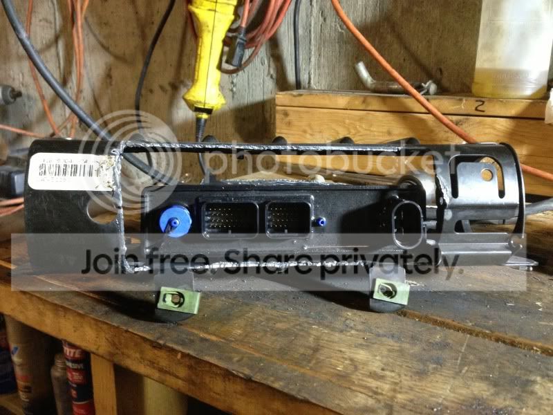

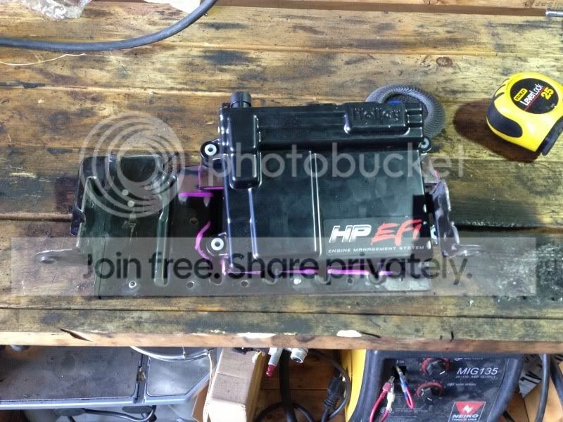

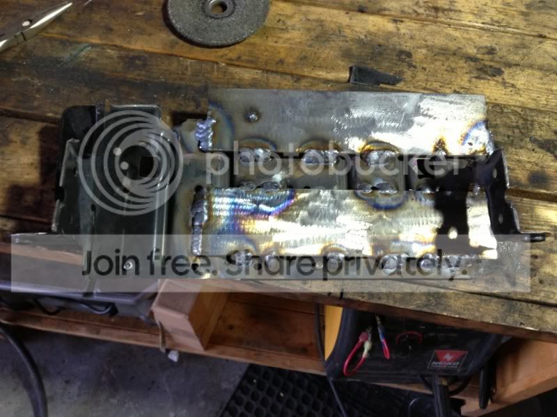

SO.... got some progress done tonight. mostly finished the bracket for the ECU... which may get re-done later on, when I have more time and metal.....

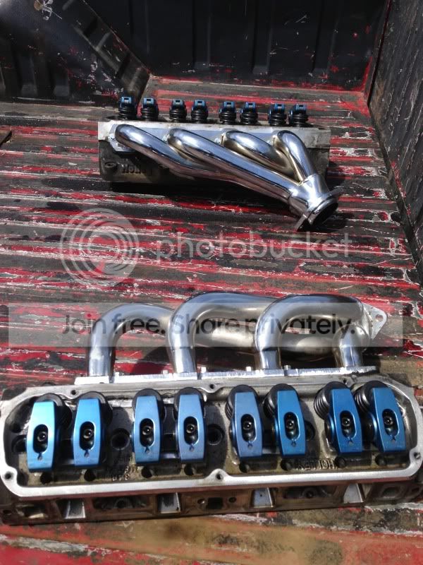

And tore down the heads... there was oil in a couple of the exhaust ports, so I decided to investigate, found several torn up valve seals.... the guides are fine. gonna send the whole mess to the machine shop to be ran thru the hot tank tomorrow... these heads are GRUNGY!!!!

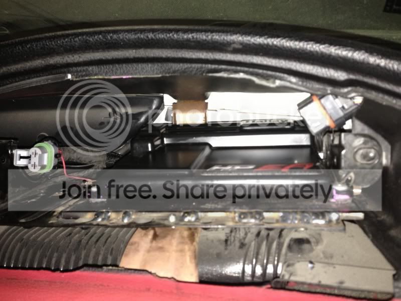

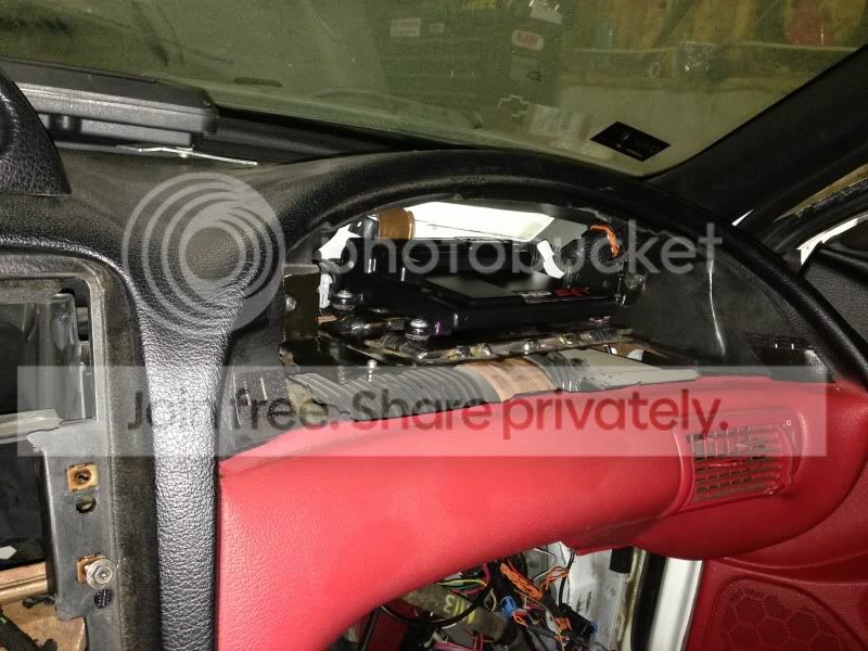

MOAR progress, got the bracket done for the ECU, checked all my external lights to see if I had turn signals and such, then ops checked the ECU. IT LIVES!!!! the digital dash works, the ECU cycles the fuel pump and sees all the sensors, and I was able to connect to the laptop and download tunes. sweet!!!
as an added plus, I was able to retain the stock airbag cover... it snaps on over the ecu, for full stealth mode. Now to build the brackets for the LCD screen so it can be tucked in the center console.

Nice dude that turned out sweet . I just ditched the ir bag too and kept the cover and snapped it back on . I like the stealthy hidden install for the ecu its clean and easily accessible .
