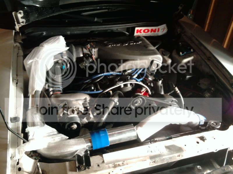

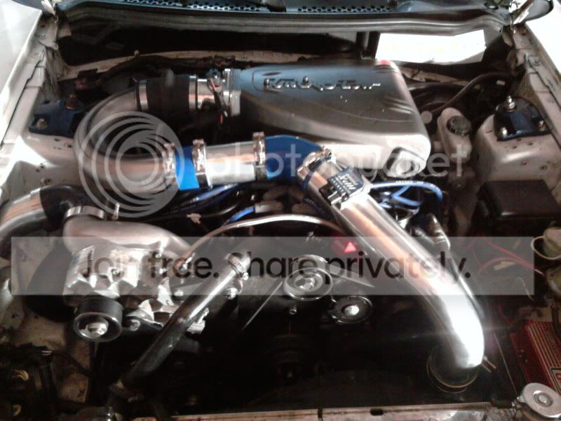

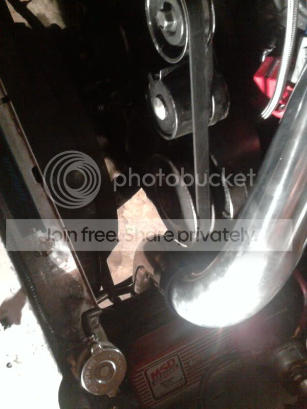

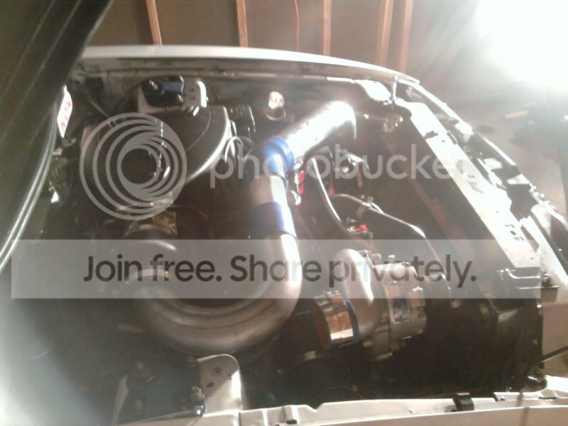

Thanks man... fighting some minor tuning issues since I set up the intercooler, but heres the install pics
and the final install....
