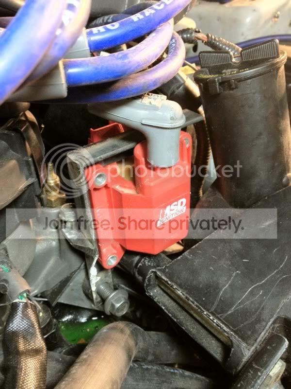

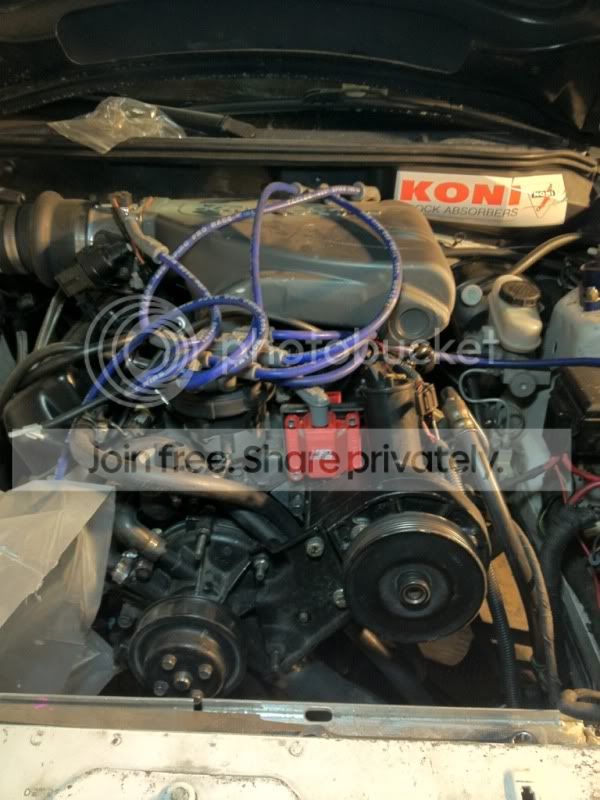

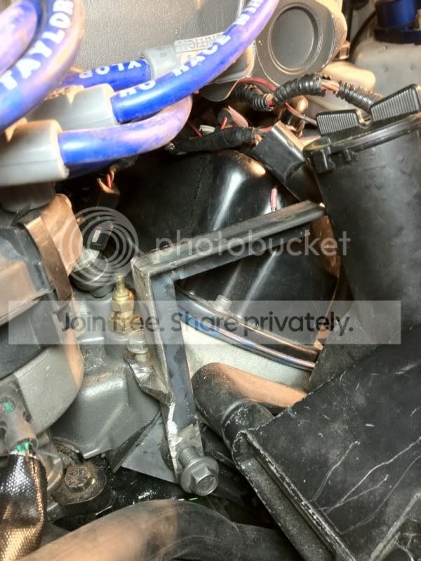

So. Got some quality garage time today, Fabbed up a coil mount. My coil wire wouldn't reach the fender, and I'm running fox accys, which don't have a provision for a coil mount. So, I made one. I gotta finish it and weld it up, but it works! I also cleaned up a bunch of wiring, and cleaned up the inner fender well. Figured I'd get all this done before the turbo setup gets here. It's dissasembled and ready to get some more power.
