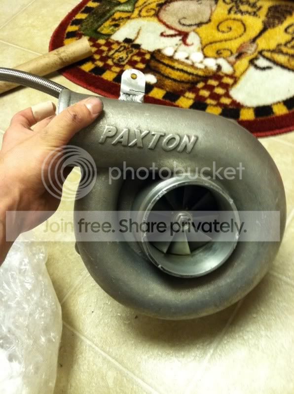

Last week i pulled the trigger on a Novi 2000 headunit, bracketry, braided oil lines, and all hardware. It was such a great deal for an excellent condition blower that i couldnt pass it up. I still need te discharge piping, powerpipe, injectors, maf, fuel pump, pulley, and gauges. I figure i can get everything i need before the tune, including what I already have for just over $2k...yea, i got a sick deal! I'll be updating the thread throughout the winter as I collect parts for he build! Here's a few teasers...
