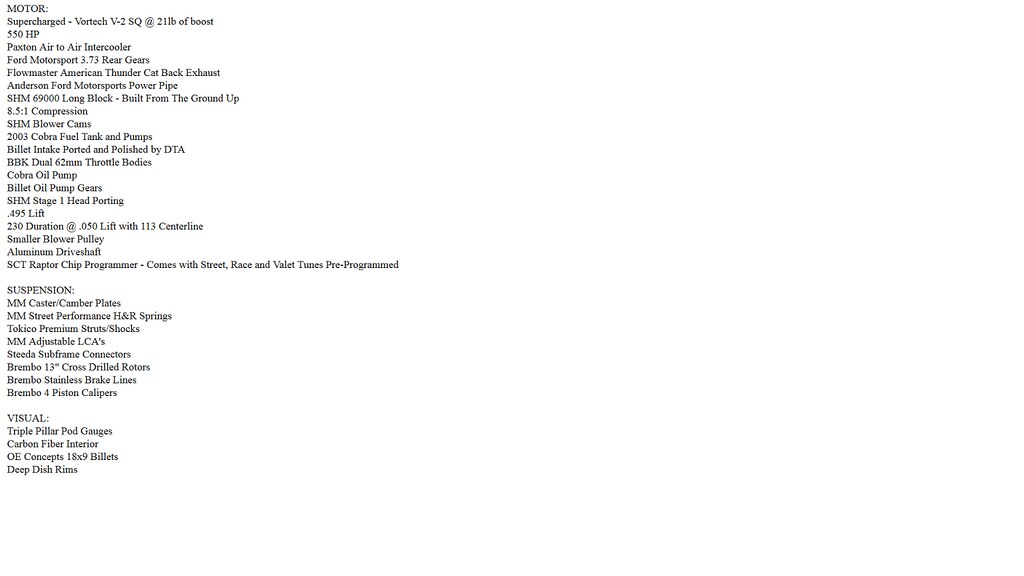

Since I'm for whatever reason unable to post the entire mod list, the car has a Vortech V2 SQ supercharger and SHM 69000 Long Block (believe it's a 5.0). Cobra fuel tank and pumps, cobra oil pump. SHM stage 1 head porting. 8.5:1 compression. Running at about 21 psi. Only thing is I don't know if it's dyno tuned? SCT Raptor Chip Programmer - Comes with Street, Race and Valet Tunes is what he has in his ad, told me about it in person too. I don't know if they're just preset tunes or it's just switching between maps

Mod List (couldn't write it out so I took a picture):

Seems like a good trade if you assume it was built properly. Judging from the pictures it looks like it has been. Take a really close look at it and be super critical. If no alarms go off and it looks like they took pride in their work I think it would be a good trade. It has some great parts.
Although, I love deep dish bullitts but I'm not sure on this car if they fit it...

Yeah man! I'd say pick it up too. We'll work on finding it a new set of wheels but after seeing the mod list id say pull the trigger on this one

Lol @ 21 psi...there is 0 percent chance that blower is producing 21 psi just FYI. There is also 0 chance the motor would only make 550 hp with 21 psi and supporting mods like cam/bullit intake.
That seems like a nice trade to me, lots of nice stuff there

No idea, he said 21 psi. Has a boost gauge in it. He said it'll go anywhere from 21-25 psi depending on what gear / how much you're stepping on it? I don't know, I'm no expert.

Lol thats why Im chiming in, that blower will not physically produce that much boost on even a stock 4.6 2v.
The guy who is selling you the car doesnt seem to know what he is talking about.
Its a blower, not a turbo. Boost doesnt really fluctuate from gear to gear and if it does its very minimal, certainly not 21 to 25 psi. Blower spin at a set rate given RPM.
Turbos can fluctuate and create more boost in higher gears since there is more load.
The head unit maxed out would have a hard time producing more than 15 psi or so on that motor
Regardless, sounds like a good deal to me, first thing you may wanna do is get it to a reputable tuner and have them check out the tune and you can get an accurate measure of boost. power. a/f
