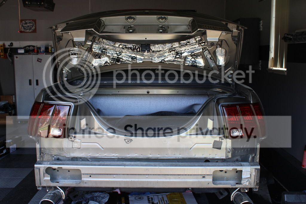

Well, warmer weather is getting me excited. I have ordered some primer, solvent, and Mineral Gray paint. I will be using this to repaint the interior under the carpet, the inside of the trunk, behind the dash, and the dash frame. Depending on how it comes out, I may do the underbody and a few other places that are not readily seen.

Damn that looks mean, rear is lower than the front?
It probably needs the spring isolators replaced; I'm getting new ones for the new suspension. Add in the stereo and it probably caused the compression.
Looks good and awesome garage too!
Thank you, the tiles are Racedeck, painted it and put up the shelves. I still have a bit more to do.
