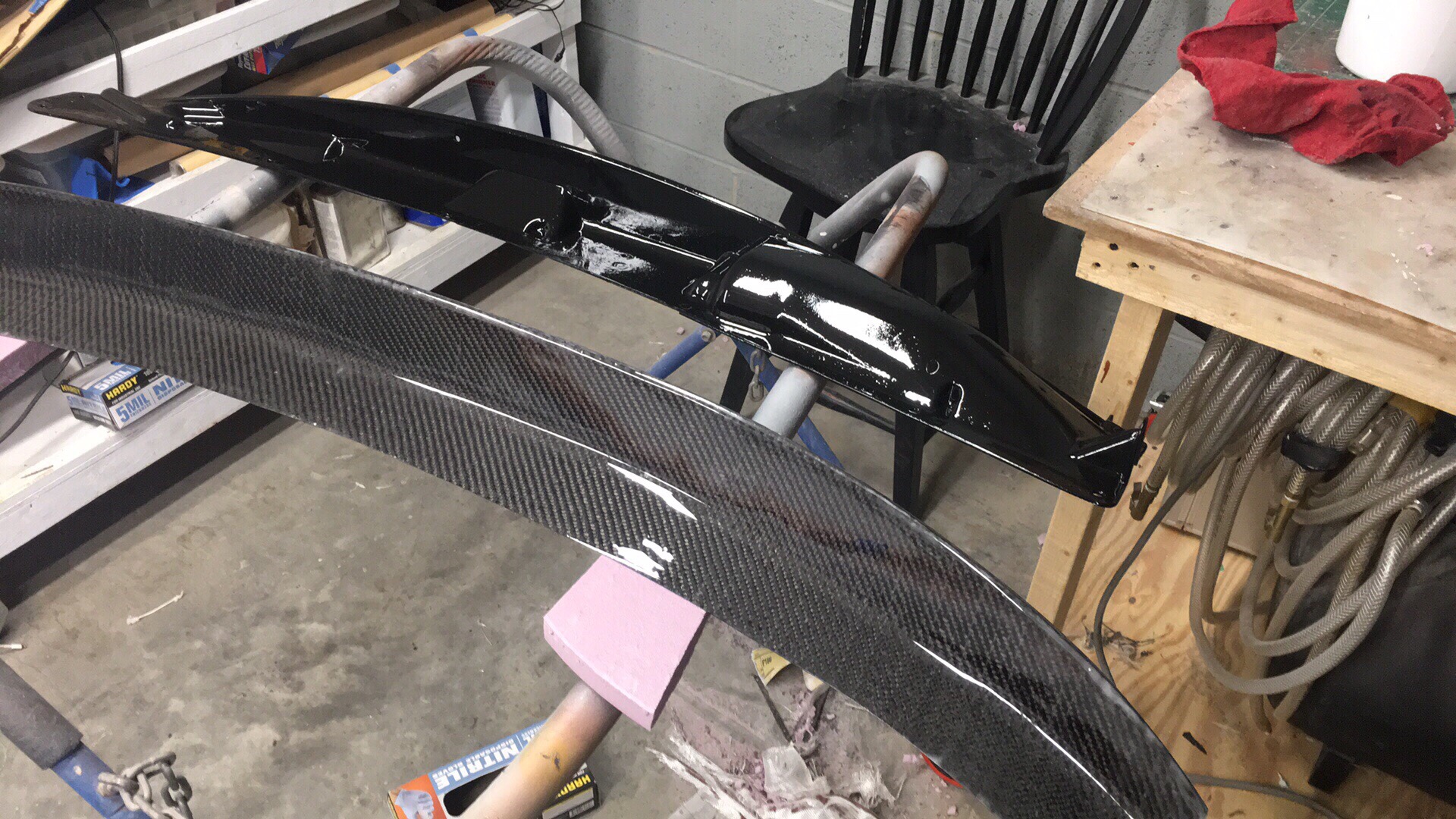

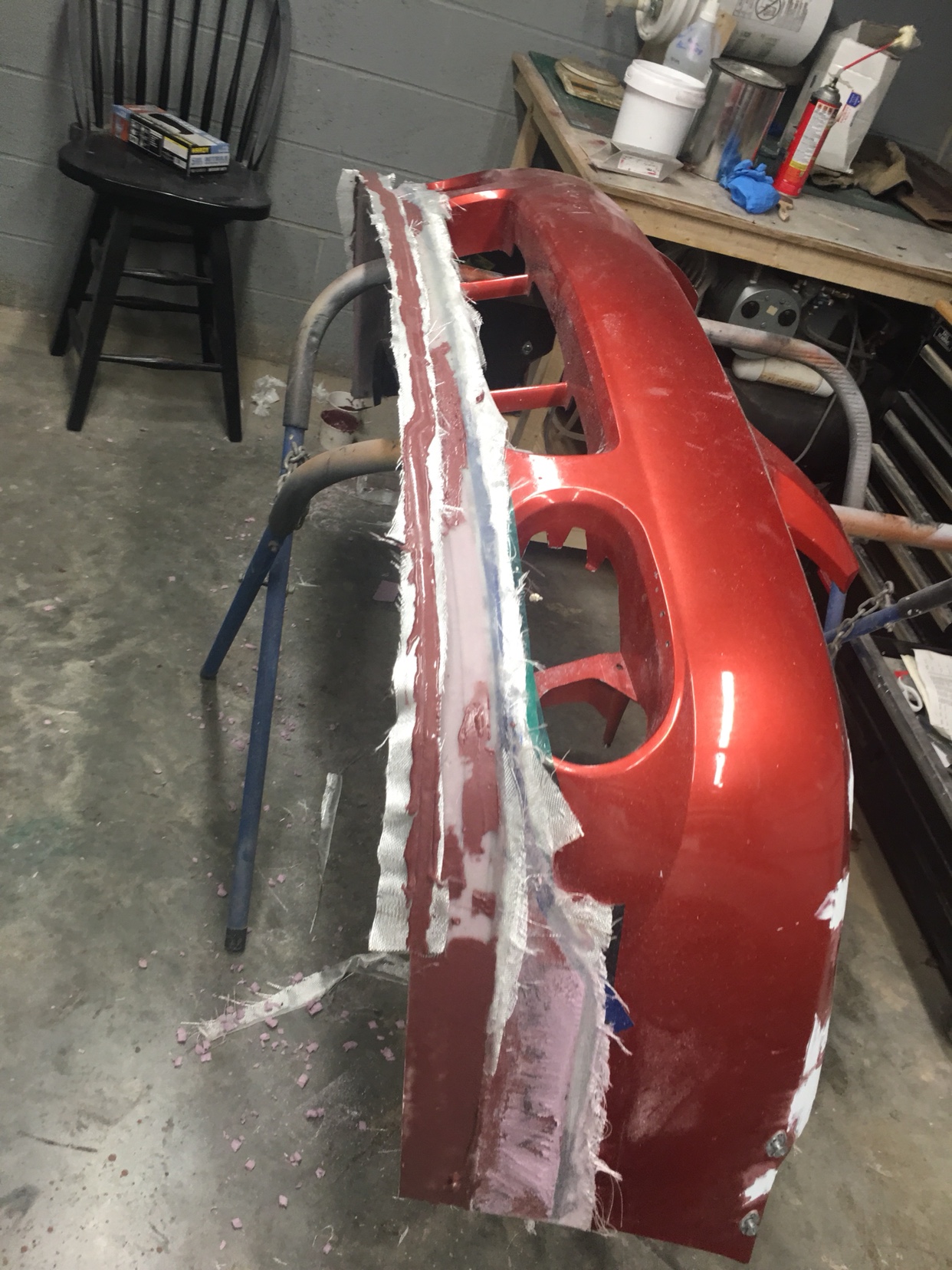

Got the last bit of fiberglass work done on the splitter. Once the top/bottom surfaces were glassed, i routed out the foam between them and filled it with epoxy thickened with phenolic microballoons, i also put 2 layers of glass over it as well.
Some of the imperfections also had the thickened epoxy applied as well since i had a fair amount of it left over.
Currently im deciding if i should permanently bond the splitter to the bumper and eliminate the seam line or just keep it bolted/pop riveted in place.
