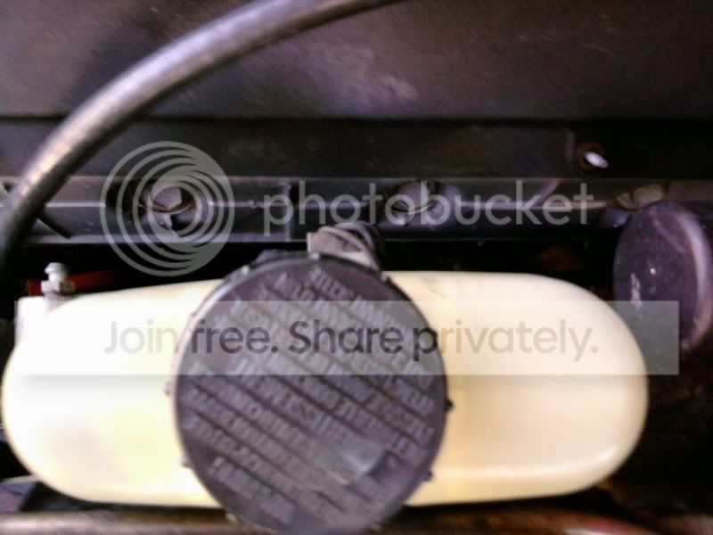

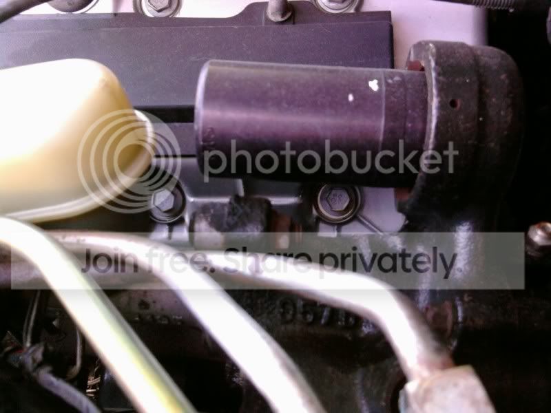

hey guys i was just looking under the hood, and i was wondering, how the HELL do you get to these two bolts?
just use an extension? it just seems like a funny angle. im sure you should torque these bolts down right?, how do you fit the TQ wrench in there?
from the pics, it seems so direct but when i look at it, it seems near impossible. is it just me?

shallow socket > universal joint > 6" extension > ratchet.
thats my best suggestion. ;-) luckily ford has a good design on their valve cover gaskets, so they stay in place pretty well durring install.

What he said. Just go out there and tear into it. It's really very easy. You don't even HAVE to remove the clutch cable if you don't want to. But you'll need to remove it upon the cam cover install

you should see where they put the cover bolts on the 2vs... ... ... geez!! lol.

You could unbolt the master cylinder from the hydroboost(2 bolts) and swing the master out of the way, that will give you some room right there. Torque spec on the valve cover bolts is 20 lb/ft just FYI.
