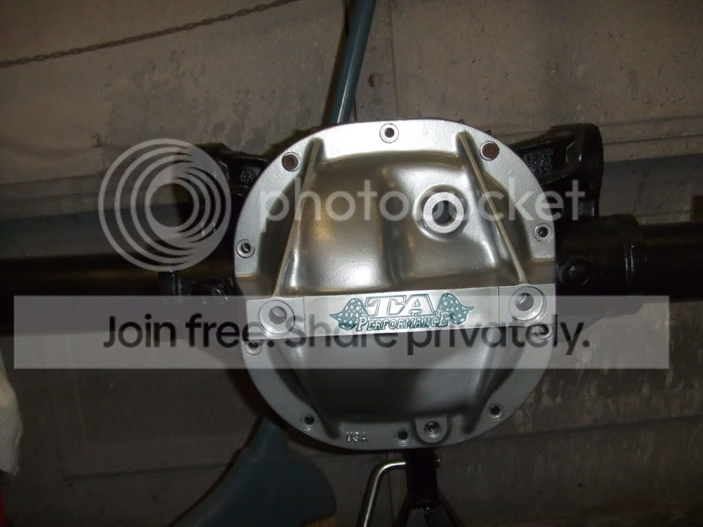

Nice work as always Paul. Kind of has a marble effect to it. Heres a pic of my latest project, still needs buffed in the emblem area but its a candy teal in the recessed area and semi silver for the main area. Ive been meaning to ask you, what did you use to bake your transmission housing? Do you have a light cureing system or did you outsource a larger oven?

That looks awesome. How did you do the checkered flags? Also, when you do the recesses, do you just spray one coat over the top, then wipe off the raised section? I want to try some multi-color stuff but I'm not sure where to begin.
For my trans, I just did the sections one piece at a time. The tailshaft housing barely fits in my oven, but it'll get in there if I'm careful. I'm still using a regular old kitchen oven. Nothing fancy.

The TA girdle looks cool too. I have one just like it, but it has Saleen ball milled on it instead of the TA logo, its cool to see one with the TA logo.
