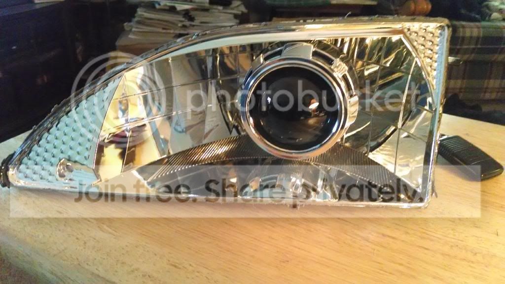

Time to get busy, I pull the headlights out:
Well i cannot find any pictures of my placing the headlight into the oven or taking them apart so i will try to make due.
I took each headlight separately, and placed them into a preheated oven at 225-250 for 20minutes. That wasnt warm enough so i brought it up to 275 for 15 mintues. When it got warm and was in the oven for the time i ended up prying the lens away from the bucket. I had to do this process 3 times per headlight
Well i did a quick test fit of the headlights:
Luckily these lights have enough space where i just could run the projector wiring through the original light socket. So no drilling
I tried some colored leds and i didnt like it...
resealed the light and tighten up everything and test fit them

Well I didnt like how Chrome and shiny the headlights look compared to the corner lights. So i pulled them back out and pulled them apart.
I got my idea from [MENTION=8860]Win[/MENTION]. He painted the inside of his cobra headlights and i tried to copy him. I have a different headlight so i didnt completely copy him
Before
After
BUG EYE!
I went this route to help match the corner lights. At the same time, I accidentally gave the headlights that smoked look because now they are darker.
That Projector line. now i do have a rainbow effect, I would think that might be from an impercection in the projector lens, or polish i used on the headlight lens on the inside of the lens that used to try to get a scratch out i had made.
