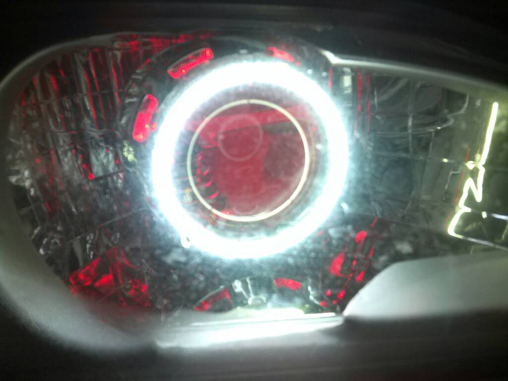

Red demon eyes + halos.

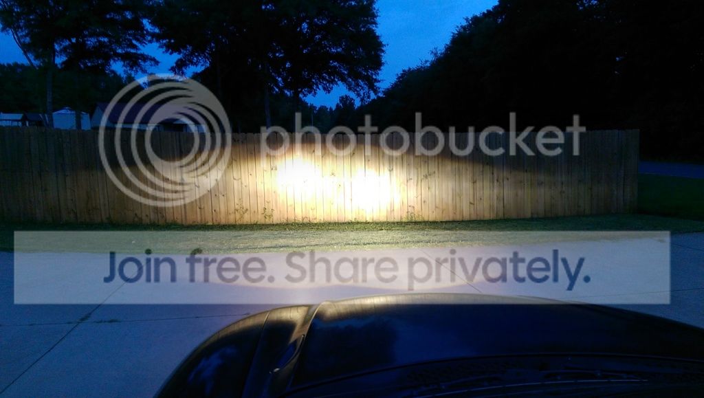

What the output in fog looks like.
I had enough thread with the thick washer but just barely. Running Morimoto mini h1 6.0 with their previous generation 4300k 3five bulbs on 55w ballasts and their previous style of halos which are $15 a pair in their closeout section (3five bulbs are also cheap in there). Cob halos have a bad reputation and I'm no exception, they're failing on me too so keep that in mind if you install some of their older ones. Also, the demon eyes are just a strip of red leds inside the shroud in my case.
