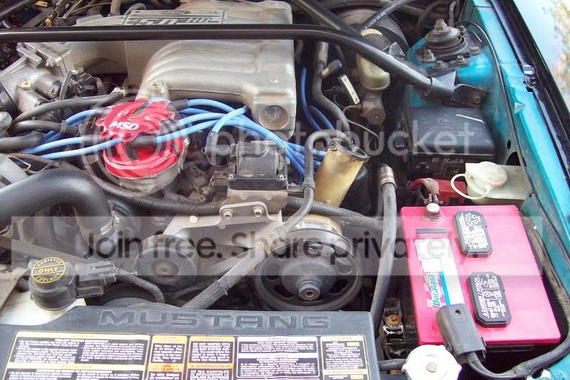

As awesome as it was, my battery died last weekend so I replaced it with a red top Optima. No big deal except it was dark and raining :wall: lol. Eventually that would have had to been done anyway.
I did pick up an MSD cap and rotor set, FRPP wires, 180 Tstat, and new plugs which all went in today. Feels and sounds a little smoother and healthier now. Cant say it makes more power or anything but it feels good. The plugs that were in there were gapped at .080!!!! No wonder I was detonating.
