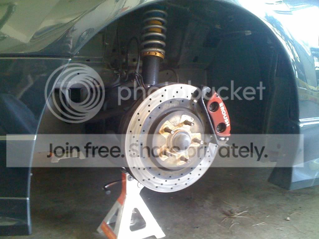

I'm completely oblivious when it comes to c/o's. How do you adjust ride height, and how far can you go? Do all c/o's adjust?
MadStang
Apr 12, 2008
4,553
114
Escondido, Ca
In the coilover kit will be a threaded sleeve that goes over the strut. on this threaded sleeve are two collars. To adjust the ride height you just rotate the lower collar that's located on the sleeve. Rotating it lower = lower ride height. Rotating higher = higher ride height. You can go as far as a the threaded sleeve or the underbody of the car can go. I could only go a little more than halfway down the sleeve without being too low on the street.
Not all coilovers are "adjustable". S197's technically have coilovers from the factory, aftermarket kits are mostly adjustable...
