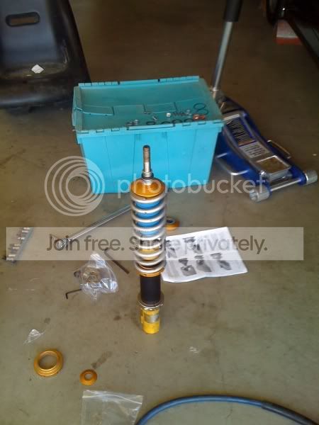

This is my bilstein front strut with the coilover kit installed on it:
Then installed:

No problem, coilover just means the coil goes over the strut or shock. This is what this thread is for, taking the guess work out of everything.
Nothing special required, just read the details in the instructions throughly. There are a lot of little o-rings, and parts that can be lost or misused if the instructions arent followed to the T.
