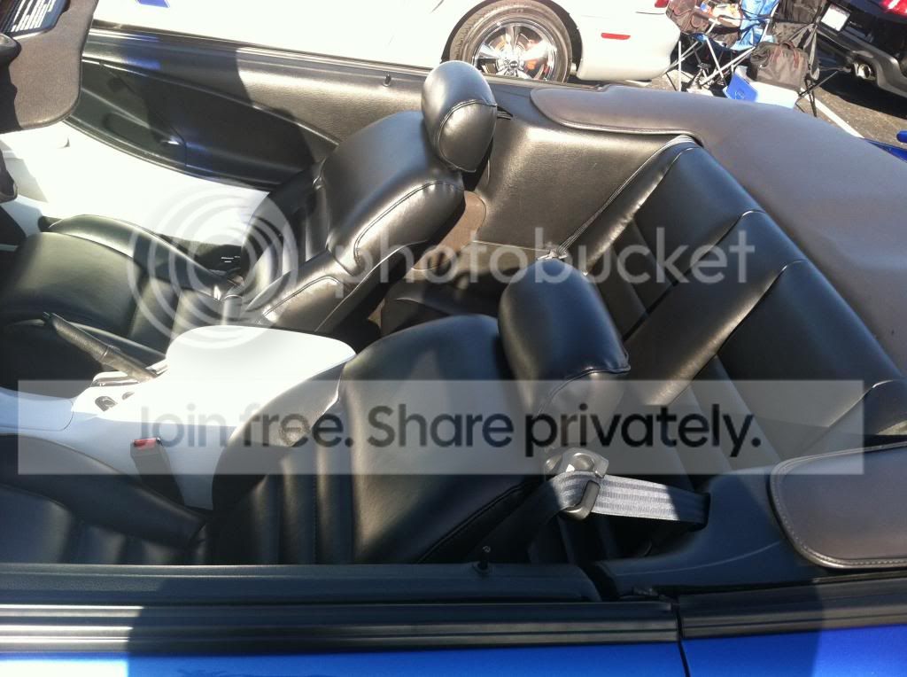

Below is a picture of a our upholstery installed in an SN95 Convertible. This guy found me at Mustang Week last month and brought me over to say how much he loved the covers and show me how well they came out --- he also told me he wouldn't ever do another set again due to it being such an intricate ordeal. He said he'd rather pay a pro.
