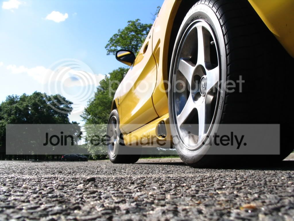

What kind of work is involved in the "through the floor install"
95PGTTech
May 17, 2007
1,654
Lots. Basically, order two six foot lengths of 2x2 .120 wall thickness square tube. Gut the interior. Cut two channels in your factory floorboard. Weld the 2x2 into the front subframe, through the channels and to the floor pans, and to the rear subframe. This is a difficulty level of hard even for someone who owns and has experience MIG welding and basic fabrication. However, the results are undeniable. The difference between through-floors and full lengths is greater than the difference between full lengths and stock.

I should have specified what pics I was looking for. Do you have pictures of the actual exhaust piping and muffler setup from under the car?
