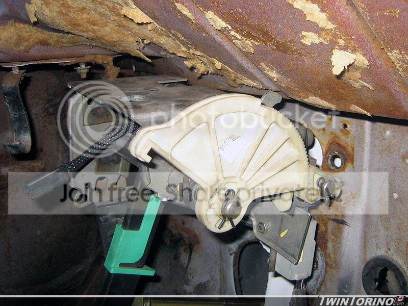

I believe this is it.I could be wrong. I do know it was under the dash

ah yes.
thats the clutch quadrant.
they fail after years of use. the teeth break off, they warp, they shatter.
you can buy aftermarket ones out of metal.
I *hate* steeda. But I suggest using their clutch quadrant, cable, firewall adjuster kit.
you dont need to remove the dash, if you're comfortable with laying on your back. lol. just pull that kotter pin on the end and slide the old one off -- new one on.

I'll vouch for the Steeda double-hook quadrant and adjustable clutch cable. Mine have worked flawlessly when I actually drive the car :) You should consider changing the transmission's fluid (unless you already have recently) and installing a short throw shifter to further improve the driving experience!
