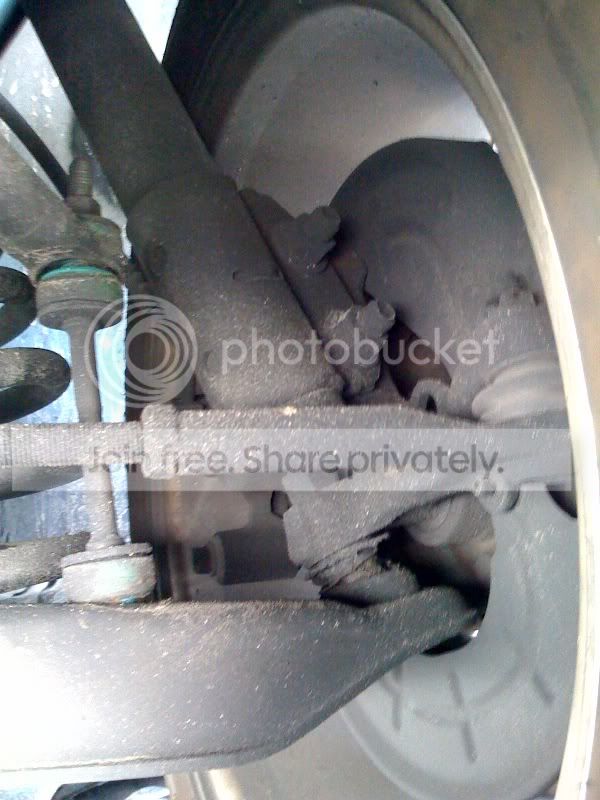

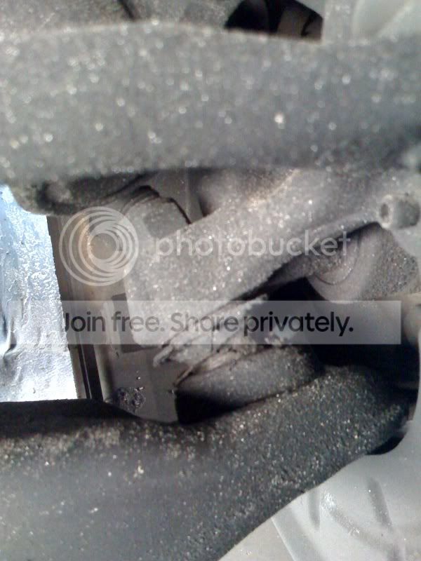

Ima jack the car up tomorrow and take pics and post them up and see anybody see if anything looks wrong

Can you tell from any of these pics?? The first pic look like the bushing is torn or something

that lower ball joint is toast. and very scary. and the sway bar bushings ain't pretty either.
