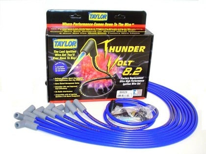

Well no gt40 heads and intake around here for reasonable prices as yet so I bought these for starters...
I will get the gt40 intake and heads when I find what I want.
I'm a little picky. so I'll wait till the right parts come available or I can get them at a pick a part.
I wont be doing any power adders on this motor so I figured the msd 6a was good enough.
I got the box, coil and wiring adapter for 211.00 shipped.
The plug wires from another site for 57.00 shipped
All new. I think a decent deal.
