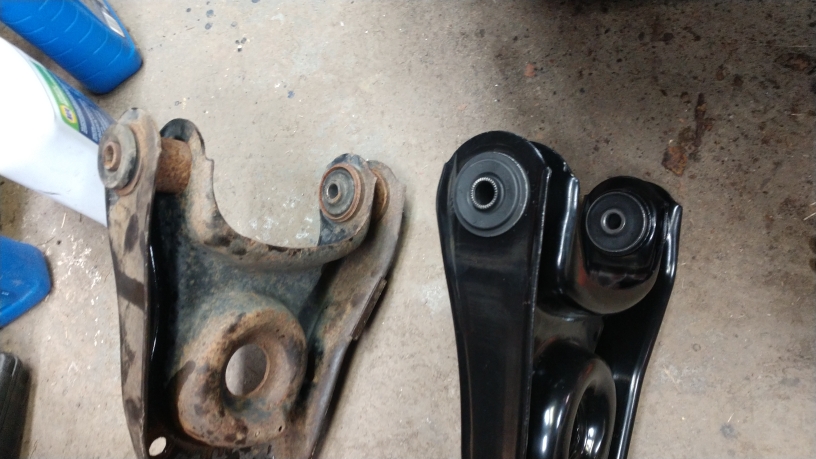

Passenger side.
I got started yesterday since the parts arrived early.
PITA moving the steering rack to get the front bolt out, but otherwise it cooperated.

Im printing pictures and packing the boxes up. unfortunately rockauto does not appear to have a way to get a real human on the phone, only an automated computer form. ship them back, let them be inspected, hope that I dont have trouble getting store credit, and order another brand...
Please please Rockauto!

Those look identical to the no name brand we just installed in my son's car. He bought a kit that came with the control arms, inner and outer tie rods, and sway bar end links. I think the total was about $200 for everything.
Anyway, the arms were a tight fit going in. It seemed like they wouldn't work. But a big hammer and some cuss words got them in.

Bummer that the bushings are wrong. If your old ones were in better shape I would say go poly bushings. I did mine years ago and they are quiet, no issues at all.

the space between the bushings in the middle is 3/8" smaller than the originals.
if it were 1/16", I'd hammer it in. if I put these in, they'll be bound in whatever direction i hammer them in at.
then i wont be able to swing them low enough to get the springs in, and when i assemble the spindles they'll be bound in the other direction. that will destroy the bushings in no time.
Nope. i want parts that fit.
Sent from my moto z3 using Tapatalk

Wow, that's weird. When I replaced mine, in 2013, with the exact same part number Moog arms, they slipped right in, no beating and banging, no sailor like cussing, easy peasy. Looks like quality control has slipped a bit:eek:

I get mine from a place called autoanything
Iv ordered for 4 of my mustangs and have not had that issue
Possibly a bad batch that place got
That dose suck no human to talk to about issues
