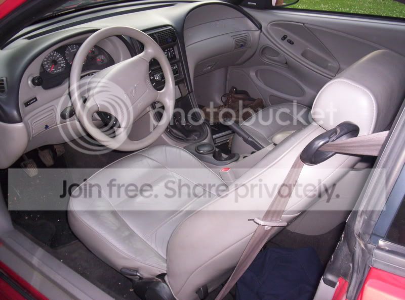

HERES A PIC OF MINE...NOT THE BEST PIC BUT YOU GET THE IDEA.
