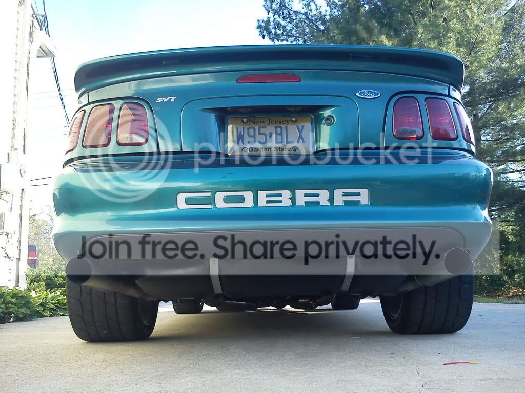

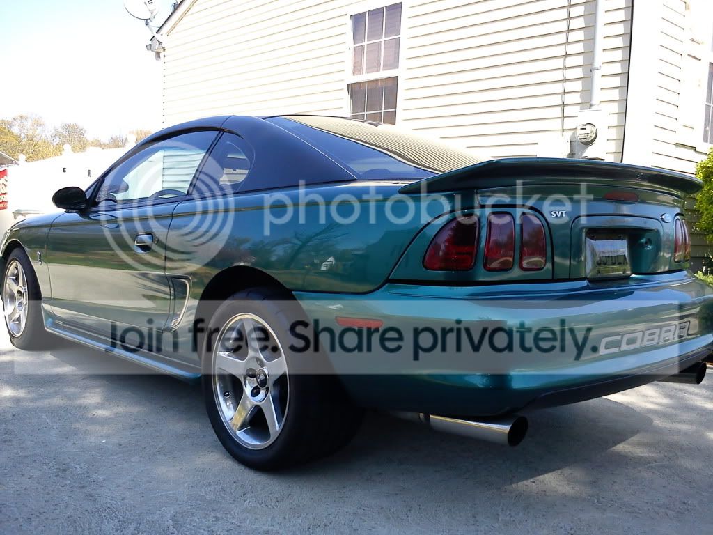

Well, been bussy this past month. Was gona get the car ready for NMRA true street in MD next month but when I reviewd the rulebook I knew I would be disqualified (no NJ inspection...) so to make lemonade out of lemons I'm just gona enter the car show. So this is what I have been doing...
New Saleen S281 wing
repainted front bumper
Had my anderson powerpipe painted satin black
Ordered Cobra grill emblem
Painted front calipers
UPR rear suspension
Lakewood 90/10 struts
New cobra headlights
New ultra clear fogs
did some wire tucking on passenger side.
painted gas tank and straps
Installed Autometer water temp gauge in dash pod
Installed Innovate wideband gauge in A piller pod
moved boost gauge to A piller pod
installed Autometer Blue LEDs to match custom gauges I had made
Bought new window tint to redue back window and to add windshield strip
Oil change (full synthetic)
I might cut 1 coil from my rear springs to drop it more. Still has 1 1/2-2 inch gap between tire and fender.
