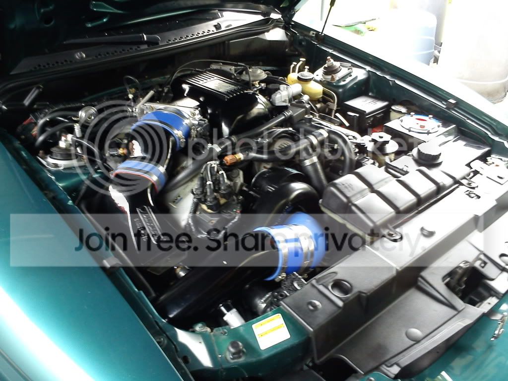

This is how the engine looks now. Notice the black theam. I now have an Accufab single blade throttle body, Vortech aftercooler (that's why the battery is now in the trunk) and stock coils now replace the MSD units I onc had. I was having major issues with them so I took them off.
