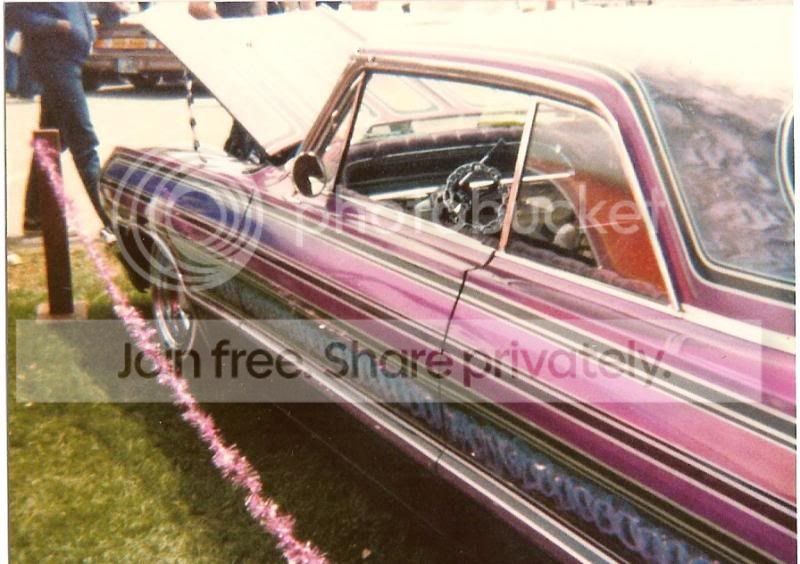

man go to good guys, or the power tour, or super chevy, or all ford nationals. billet wheels are in just about every resto mod, pro street, muscle car there, lol. it's not a lowrider thing...just a custom thing:
you guys are thinkin of some shit like this or something, lol:

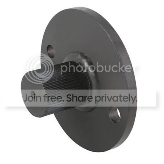

@ SLYKIN:
the problem with installing a billet steering wheel on an sn is the hub spline...this:
this is what allows you to turn your wheel. NO billet wheel company makes a hub adapter with these teeth. but however just this year GRANT steering wheels started making one to fit over these teeth:
not as smooth and clean as the billet specialties GM hub adpts. but will work fine.
the next issue will be that with the GRANT hub adapter it requires the use of a grant steering wheel.......i hate grant steering wheels. or any steering wheel you can get from auto zone.
so i will have to connect this wheel:
to this hub:
as you can clearly see....the holes in no way are even close.
so then i will just simply drill new holes through the face of the wheel:
and cover all the holes with a polished horn button:
when you remove your steering wheel the hole is round.....kinda looks like it would be rectangle but its round between the back of the wheel and the column
