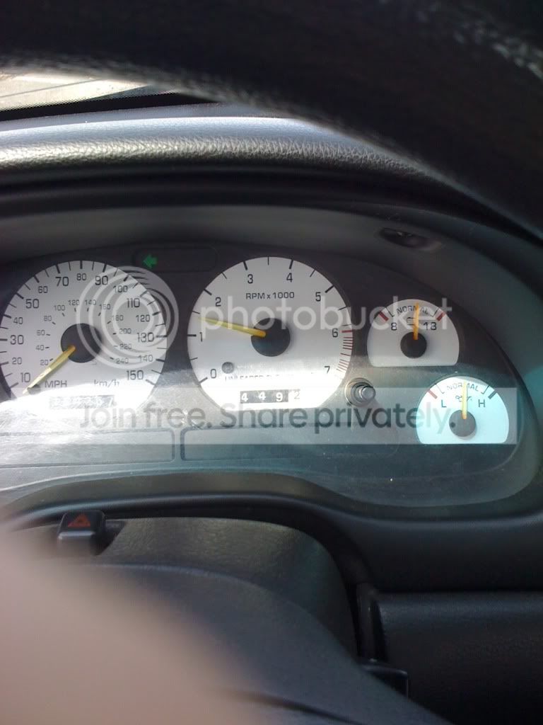

I got a new distributor and the day I picked it up the timing was slow so I brought it back, he advanced it and it ran weird for a little but then settled down and ran normal for about a day and a half. Then it started acting up again yesterday morning. When below about 1700 rpm it starts to jerk alittle and almost feels like it's going to stall even when I'm on the gas. Then if I put the petal down to accelerate fast when I get to about 4500 rpm it starts to make a noise that sounds like something plastic is being stuck into a bicycle spoke (sorry best way I can describe it) if it helps the last time I heard this particular noise is when one of my spark plug wires was off but I checked the wires as soon as I heard the sound and they are all on
Also it is idling high at about 1250-1500 rpm
Help please? I'm learning but I'm still a noob.
